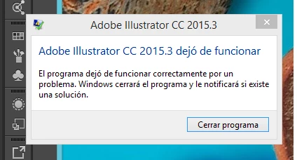

Just as the title says, the following happens, in this order:
1 - I launch AI CC 2015.3;
2 - It fully loads, even past the splash screen;
3 - However, after it loads, it stops in this screen, then suddenly the last program I used appears in front of Adobe Illustrator (Like this);
4- About 1-2 seconds after that, it abruptly crashes. There's no "Adobe Illustrator has stopped working" or "Error:" pop-up either, It just crashes and that's it.

Same problem here as of yesterday when I installed the 2017.0.2 release on both my desktop and laptop. Both are on Windows 10. After installation I am unable to start Illustrator. It crashes while on the splashscreen with the note "Adobe Illustrator CC 2017 has stopped working". Uninstalled, cleaned the system with CCleaner and reinstalled it again with no luck. The bridge-solution did not work for me. Do I really have to go back to CC 2015.3 again??
