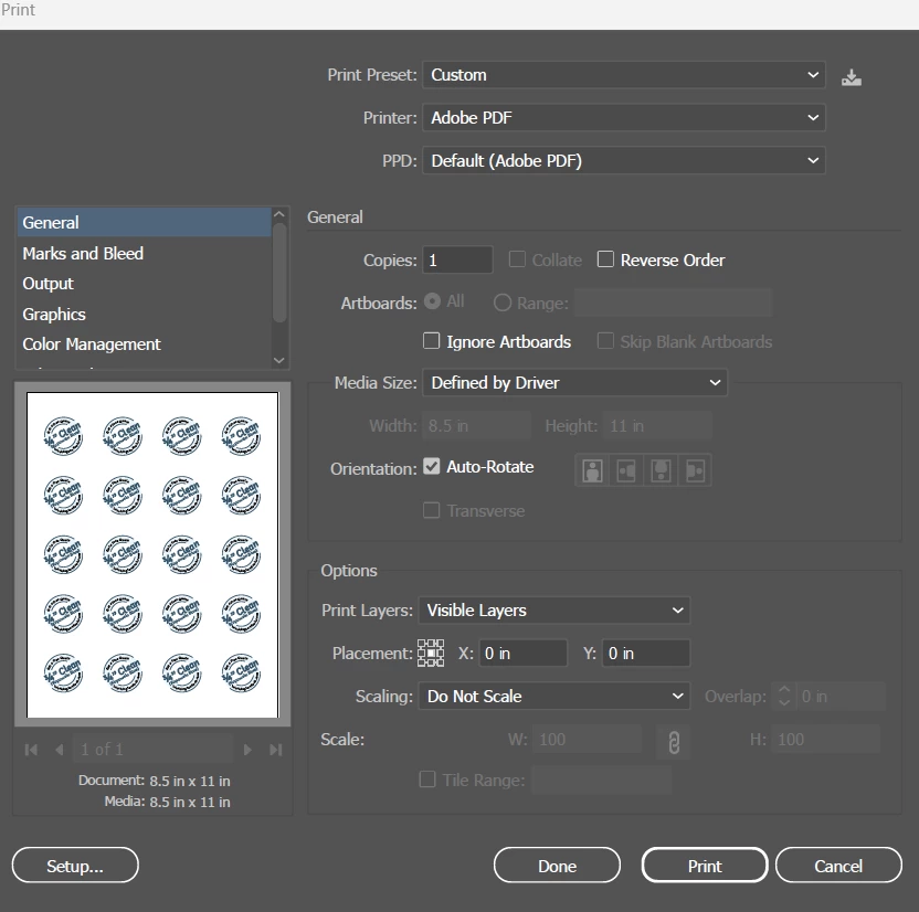

May 1, 2026 7:58 PM UTC
The only way I was able to get around this was by printing the PDF rather than exporting it or saving it. I selected “Adobe PDF” as the printer, then selected “Visible Layers” under the Print Layers option in the General dialogue box.
