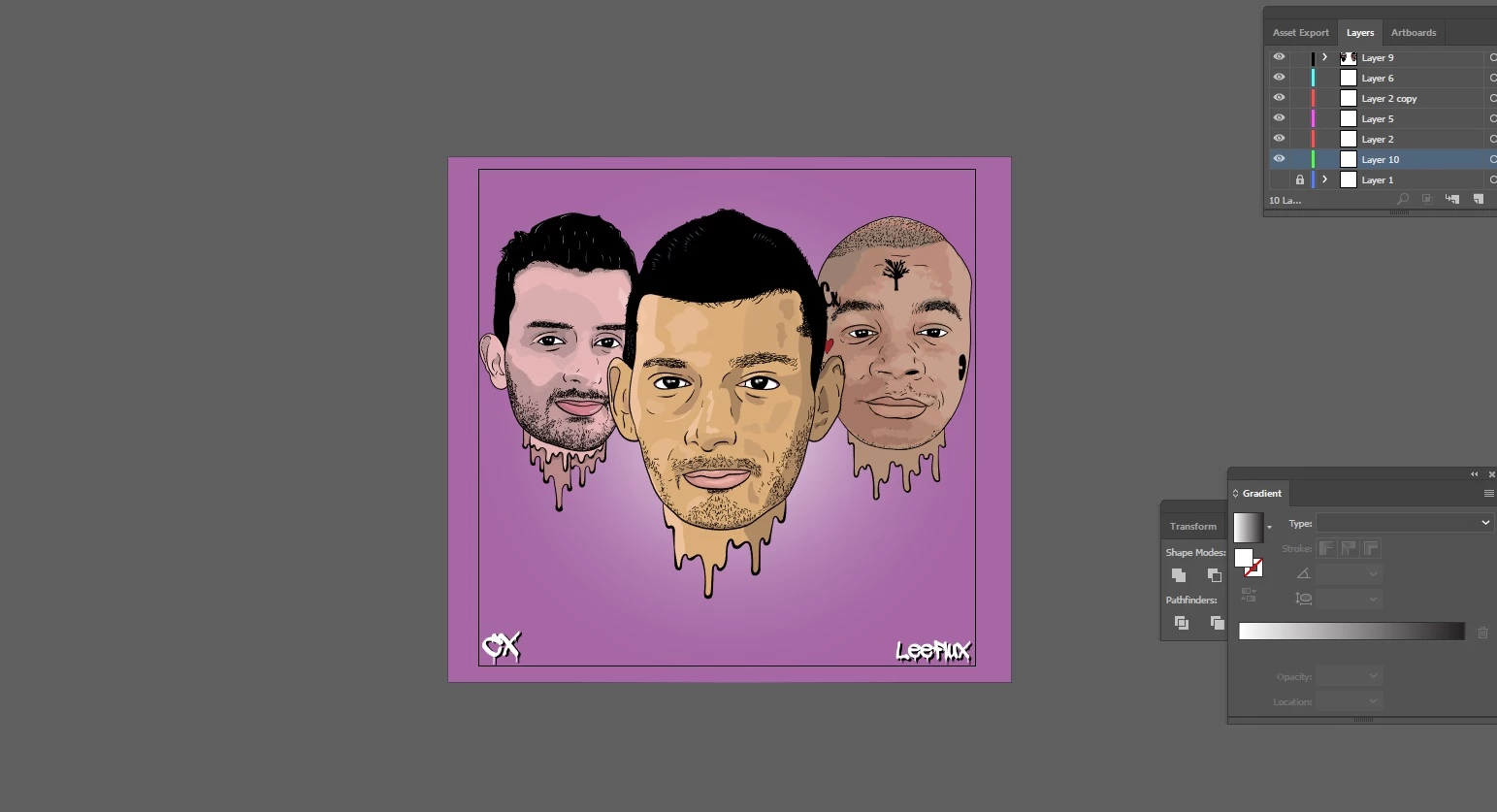

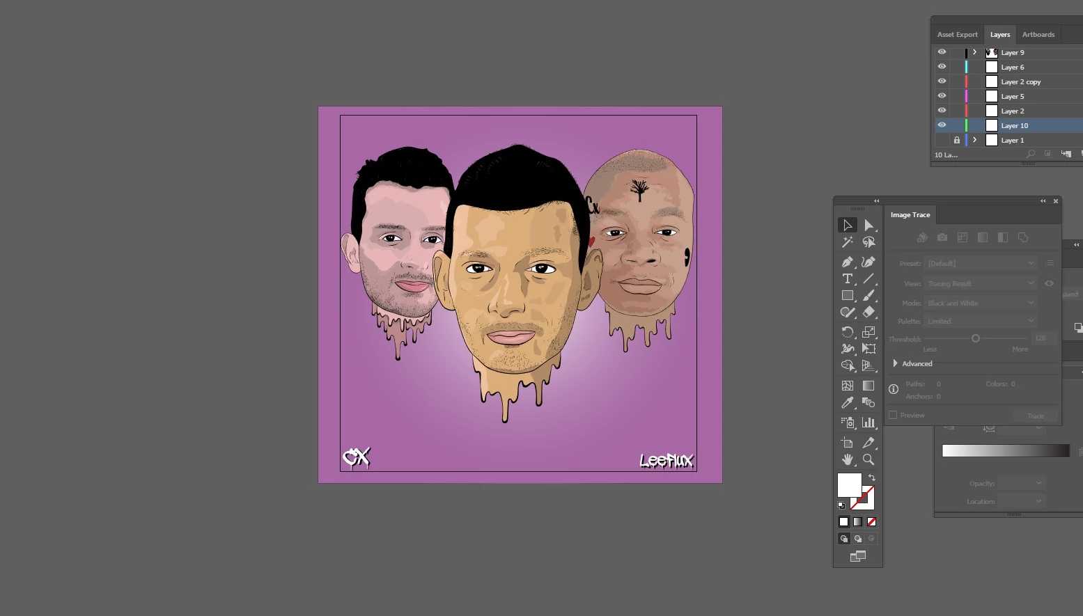

Hi guys, I have an issue with Illustrator that I can't seem to solve and would love some help if possible please!
So basically my black line-work when I zoom in and out changes from being thinner and thicker, and when I export the image, the black lines appear to be really thin and it's very annoying as when I export the image I want the black lines to be thick, not thin.
See attached images, thanks in advance!
https://imgur.com/a/MKQh5nc

Please upload screenshots directly to the forum.
What kind of file do you export?
What kind of stroke do you use? A normal stroke, variable width, a brush?
Just how thick is it? And how large is the artwork?
In case this is exported as a PDF - which app do you use for viewing?
LeeFluxAuthor
July 30, 2018
Apologies,
I export in PNG format, with anti-aliasing in 300dpi
I use a calligraphic brush with max pressure
And normally 1pt thick, but the lines that thin out when I export the file are the thin lines (Facial hair) which are 0.25 and 0.50
I view the images in paint and paint 3D, the images look the same regardless of the app
Thanks
