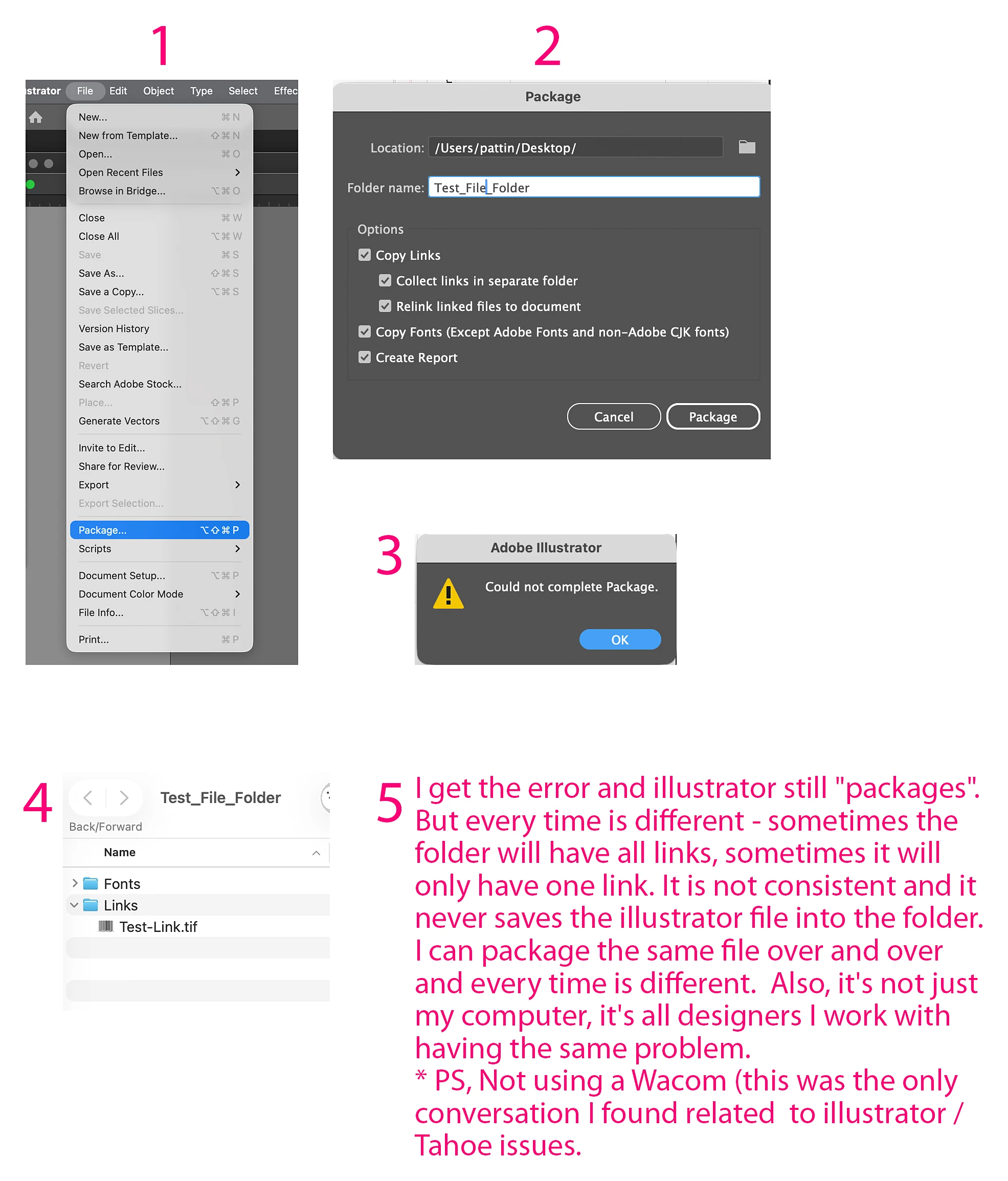

Adobe Illustrator not packaging after Upgrading to macOS Tahoe
We get the error and illustrator still "packages". But every time is different - sometimes the folder will have all links, sometimes it will only have one link. It is not consistent and it never saves the illustrator file into the folder. I can package the same file over and over and every time is different. This is not just my computer, it's all designers I work with having the same problem.
* I have tried working from our server and also working off my desktop.
* OS and Adobe updates are current.
* Not using a Wacom (this was the only conversation I found related to illustrator / Tahoe issues.
Our IT team has tried going through the process with adobe, but no one can figure out why this is happening. I was hoping someone in this community would have a fix. Thanks
(screen shot attached for settings reference)

Are there any updates regarding this issue? After upgrading to macOS 26, our designers are reporting that they are experiencing the same problem as well.
We cannot switch to AFP because all of our file servers are Windows servers, so SMB is required.

Additionally, we have tried to:
- Uninstalled illustrator
- Run adobe clean up
- Checked, and issues are not with the links.
- Adobe reps have logged in twice and tried a few things… the last guy said they would have to create a "Patch” for this, but can’t give a date.
That's why I'm hoping someone here can advise. 🙂
And then, I guess the next thing will be to wipe our computers and manually install the last OS version so we can use illustrator for our best needs.
September 25, 2025
PS: We have already checked for setting and font conflicts
