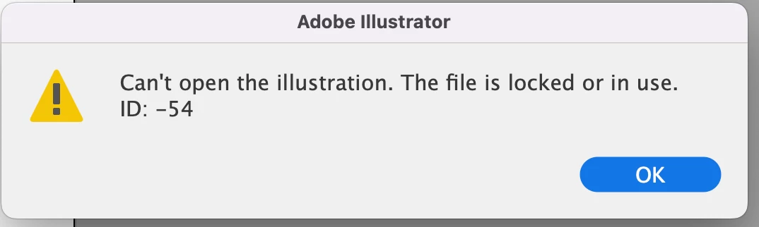

I am getting the following error:
I will work on a file and save it. And when I try to re-open the file I will get this error. I am saving my files on a server. Also I do not want to keep moving my file from the server to the desktop and back to the server everytime.
Kevin Stohlmeyer
Kevin StohlmeyerCorrect answer
Jul 29, 2022 6:57 PM UTC
Stop accessing files on a server. Drag them to your local HD and you wont have this issue. Then save and drag them back.
This is a common issue with remote drives/servers. The OS is not refreshing fast enough and thinks the file is still in use by either the OS (file previews, etc) or another application.
Officially Adobe does not support saving across network/remote servers/drives:
https://helpx.adobe.com/photoshop/kb/networks-removable-media-photoshop.html

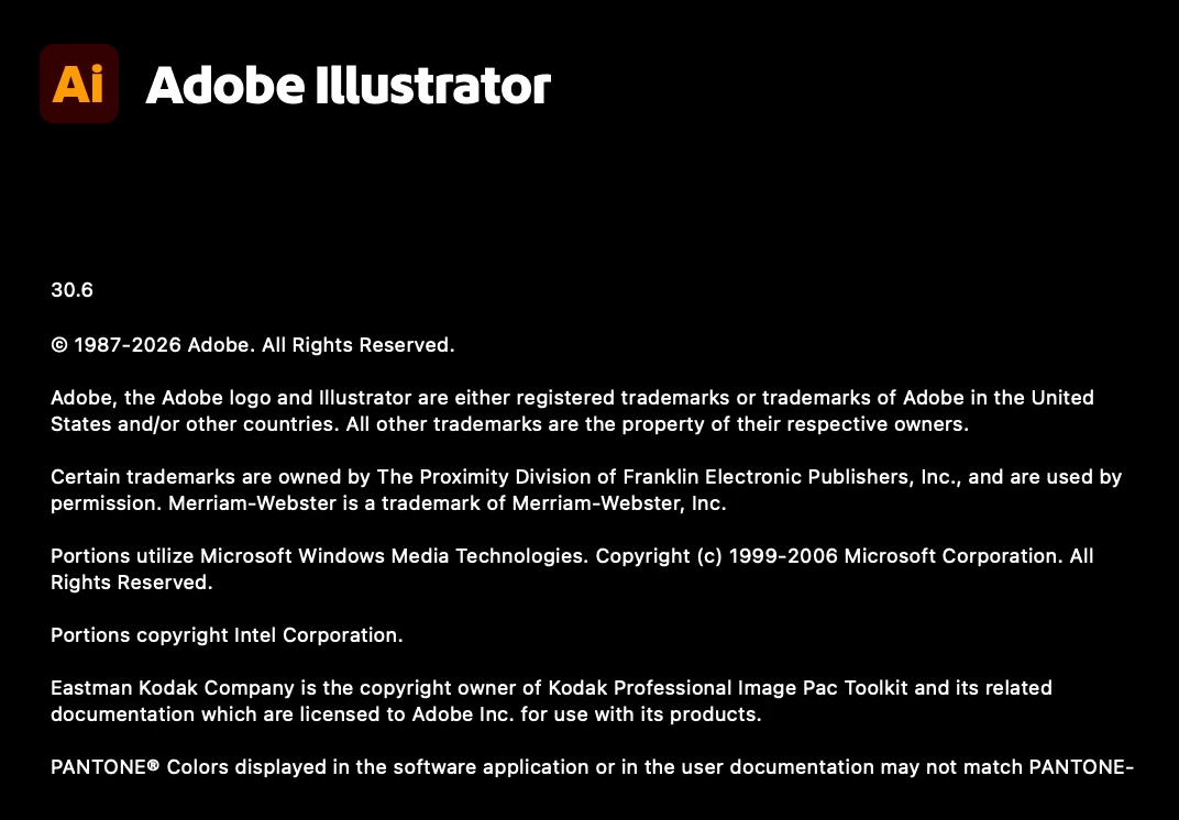

Sep 11, 2026 1:11 AM UTC
I’ve also been having this problem for the last few days on Macbook Pro with Tahoe 26.5.1, Illustrator v 30.8.1. I access my files from a Sharepoint network. I’ve never had this problem before. I don’t understand why it would all of a sudden start happening. Having to save locally and then back up to the server is a major inconvenience.

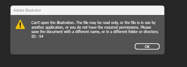

Jul 24, 2026 2:24 AM UTC
Im having the same issue today. using latest version of illustrator on windows desktop and laptop.
im using portable ssd to copy the files from desktop to my laptop, back and forth all this time. not using any cloud saving whatsoever. only today this happen.
please help to fix as i need to use the file as soon as possible.

Hello ​@KEVIN28166455hkat
I’m sorry to hear you’re having similar trouble with Illustrator. Would you mind checking if this happens with specific files or if the local folder where you’re copying the files to is being actively synced by another application like OneDrive/Dropbox/etc, so we can assist you further?
Looking forward to hearing from you.

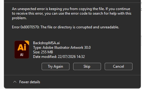

Jul 27, 2026 2:08 AM UTC
hey, thanks for the response!
and no, i dont use any cloud application such as One Drive, Dropbox, GDrive, Mega etc at all.
as i mentioned, this file only been through transfer from my laptop office and home pc using portable ssd.
i tried to copy paste the file to other local directory, it shows this:
any way to fix this?

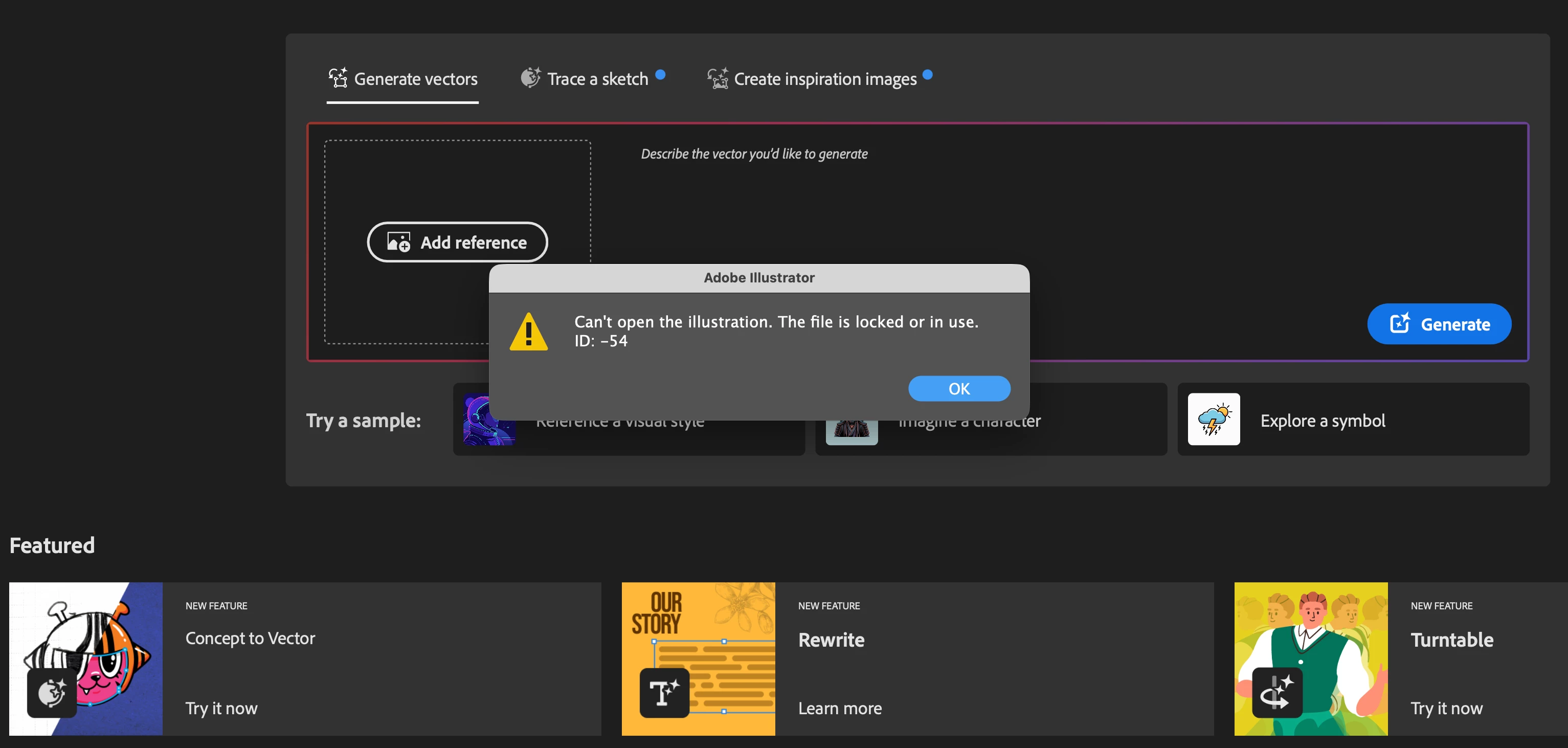

Jul 23, 2026 7:21 PM UTC
I’m getting the same issue here too. Latest version of Illustrator on an M1 Macbook Pro. I’ve already tried downloading the file to my HD but still no luck. Please fix immediately or explain how to access the file. I am under extreme deadlines to get this finished and suddenly i cannot access a file i was working on last night.

Jul 21, 2026 12:47 PM UTC
Thanks for your response. I am on a iMac 24-inch 2024 - Apple M4 running Tahoe 26.5.2. I am not trying to load a file from a server or an external drive. I downloaded this file from a Car Blueprint market place, like I have done in the past.
Thanks in advance
