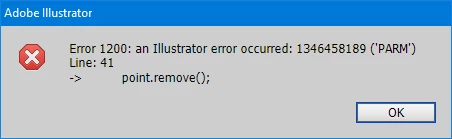

The following scenario gave me an error. What is wrong?
1. create new layer // it becames a current layer
2. draw point (ellipse). // obj ref is `point`
3. cut & paste
4. deselect all
and
point.selected = true;
point.remove();

@andyf65867865 - Could you please share code what exactly you are processing. Tried the following snippet based on your steps and it works well
var _doc = app.activeDocument;
var _layer = _doc.layers.add();
var _point = _doc.pathItems.ellipse(0, 0, 30, 30);
app.executeMenuCommand('cut');
app.executeMenuCommand('paste');
app.executeMenuCommand('deselectall');
_point.selected = true;
_point.remove();
Best regards

Hi @Charu Rajput, please try this.
(function() {
    var doc = app.activeDocument;
    var newLayer = doc.layers.add();
    var point = doc.pathItems.ellipse(0, 0, 1, 1);
    point.filled = true;
    var whiteColor = new CMYKColor();
    whiteColor.cyan = 0;
    whiteColor.magenta = 0;
    whiteColor.yellow = 0;
    whiteColor.black = 0;
    point.fillColor = whiteColor;
    point.stroked = false;
    app.executeMenuCommand('Find Fill Color menu item');
    app.executeMenuCommand('pasteFront');
    point.remove();
It seems that it is the 'Find Fill Color menu item' followed by cut & paste that is causing this error.
