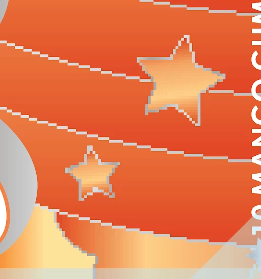

I did not notice any problems at all until this morning. When copying a client's artwork into my dieline a lot of the vector data was somehow made into raster. Or at least it appears so. In outline mode not of the paths are there and the artwork looks really low res and bitmapped.
I confirmed a couple things. It prints that way as well AND a coworker who did the same upgrade as me has the same issue.  The file I am using is from September and I had no issues with it at that time so I can assume the file from the cleint is OK.

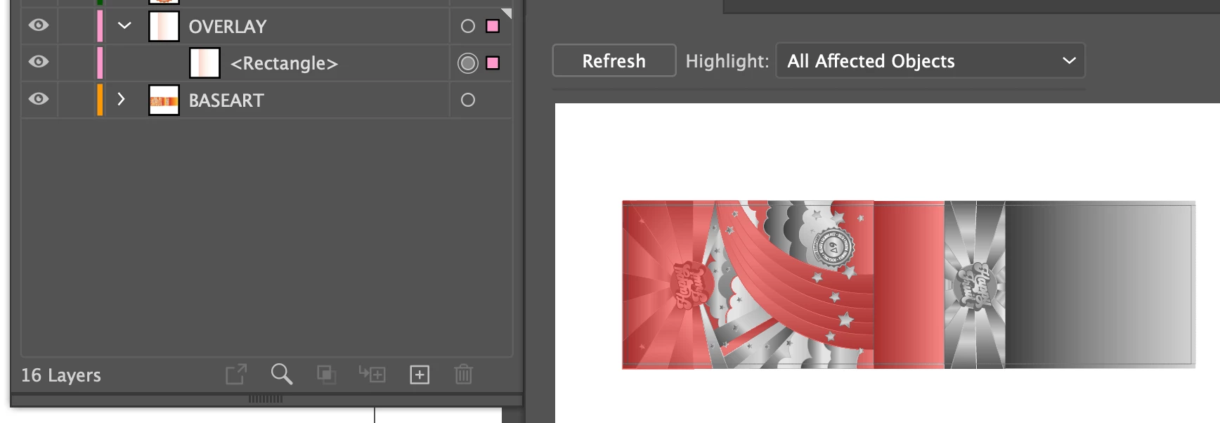

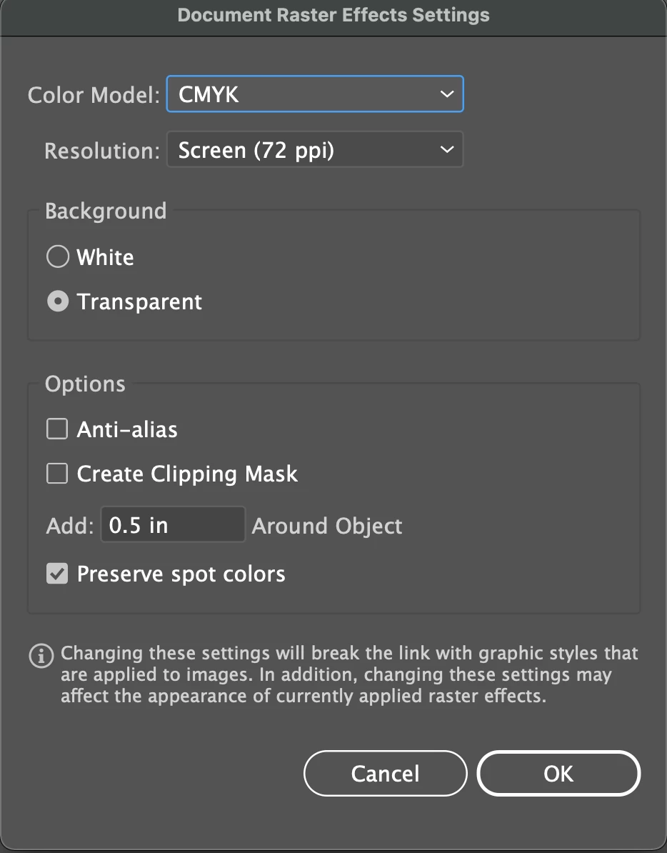

Using the Flattener Preview you can see what regions contain transparency and what objects are affected by Transparenncy. I downloaded your file adn see than most of your art contains trasnparency or is affected by it. The document also has Document Raster Effects settings set to 72ppi (Should be set to 300 PPI) This can vary between documents and it could be that the dieline document has a different setting to the original. If you create a print document then document raster effects settins is set to 300 PPI by default. If you create a web document then that is set to 72ppi, I would suggest to check teh blank dieline document to see if it is cconfigured correct.
You say you are using ESKO plugins, is that for trapping? As far as I know ESKO plugin is not compatible with 2022 yet. This may mean you are switching between versions in your workgroup. When switching versions of Illustrator the PDF part of the file may be used rather than the Ai file. This can cause flattening to occur and depending on Reaster Effects (Effects > Document Raster Effects Settings… ) settings and Transparency settings may cause rasterisation. Set Edit > Transparency Flattener Presets to High Quality.
I believe you have option "ESKO PDF", I would not recommend that option if it comes up if you have transparency in your art.
Your Rectangle in the layer OVERLAY (and SEAL AREA) is what is causing your artwork to flatten. In your layers panel a filled circle lets you know there is a complex appearance and should give you the heads up to know it is a layer that may cause problem in certain workflow. (Flattener Preview markes Red Objects Affected by Transparency)

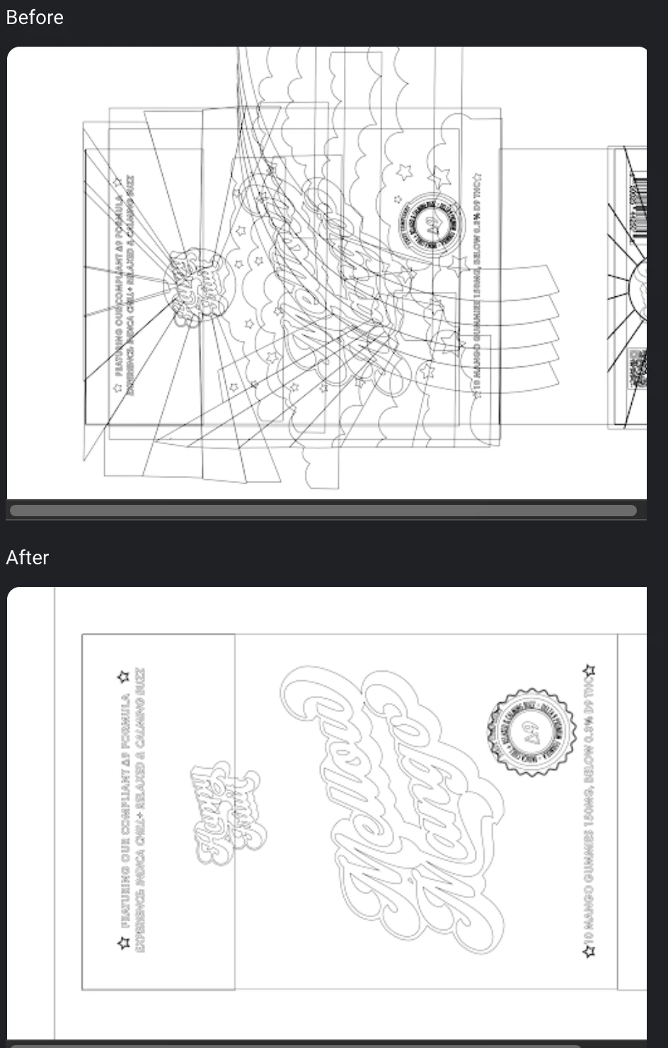

And here is a before and after in Outline Viewing...

What does your Effect > Document Raster Effects > Settings... show for Resolution?
