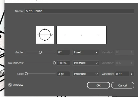

I am using AI. When I set the brush stroke to "presure" it works on my Wacom tablet. But when I go to my artwork all I get is a solid line without varying thickness. How do I fix that? On my artwork page I have set the pen to "pressure" but to no avail. Please advise.

Can you please show us the settings in your brush?
February 26, 2023
I am enclosing the brush stroke setting and the result of the brush stroke in the artwork
Monika Gause
Monika GauseCommunity ExpertCorrect answer
February 26, 2023
Drag the Variation slider to the right.
