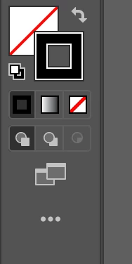

Dec 12, 2018 3:35 AM UTC
I've noticed that in CC 2019, they have made the left hand tool panel customisable (it may have been in previous versions, but I didn't use it). What I have found is that occasionally the tool panel goes crazy and re-arranges itself. Where the direct selection tool is normally (top right spot) another tool is in its place. I have noticed a correlation between this getting re-arranged and the handles disappearing.
If you reset the tool panel back to default layout (via the 3 little dots under the tool panel), this seems to fix the disappearing handles issue. Maybe Adobe should look into this (as to why the tool panel randomly re-arrage the tools).
Oct 4, 2019 7:02 PM UTC
Hey...This ACTUALLY worked for me. I just clicked the ... and my middle handle reappeared!!
