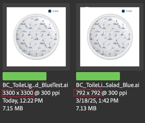

Interesting.  I looked at both of the examples above with more metadata selected to display and this is what I got:
for the one displayig  792 px Sq @ 300ppi  the metadata is showing 6.7 cm sq, but the transform panel shows 19.3 cm sq.
For the one displaying 3300 px sq @300ppi the meadata is showing 27.9 cm Sq. but the transform panel shows 19.3 cm Sq.
so you are right, it seems to be a Bridge thing. Do you think it is giving me the thumbnail size? There is a difference in scale when I hit the spacebar to preview the images in Bridge.  the 792 gives me a smaller preview than the 3300 does. thanks for sticking with me on this.
Luckily this does not affect export or print. You may want to check the Bridge forum, maybe someone there can explain it: https://community.adobe.com/t5/bridge/ct-p/ct-bridge?page=1&sort=latest_replies&lang=all&tabid=all

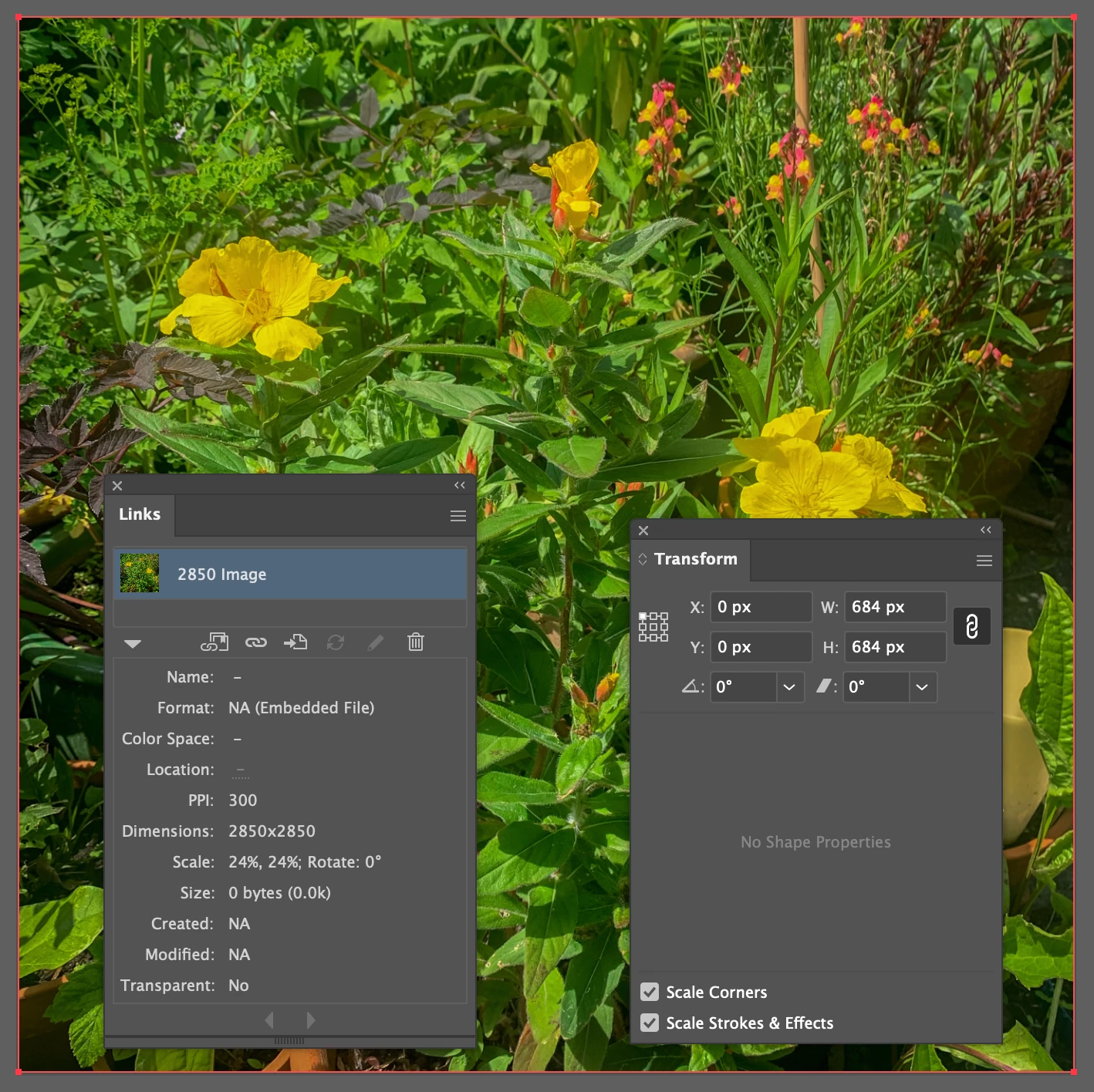

Illustrator just scales the image to honor the 300 ppi set in Photoshop.
The amount of pixels is the same, the image is scaled 24 %.
Regina 7Author
June 12, 2025
I kind of get what you are saying, but why would the file save it as 648 sq vs the next time I save it the same way it saves it as 2850 Sq?  I have attached a screen shot of what I am talking about. this is a differnet file than the one I have been referring to, but it is the same question.  Just wondering why it would save seemingly indescriminantly at two different sizes.
