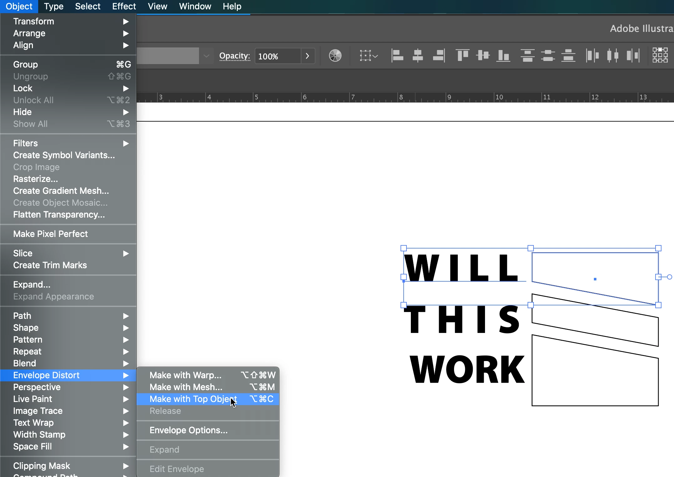

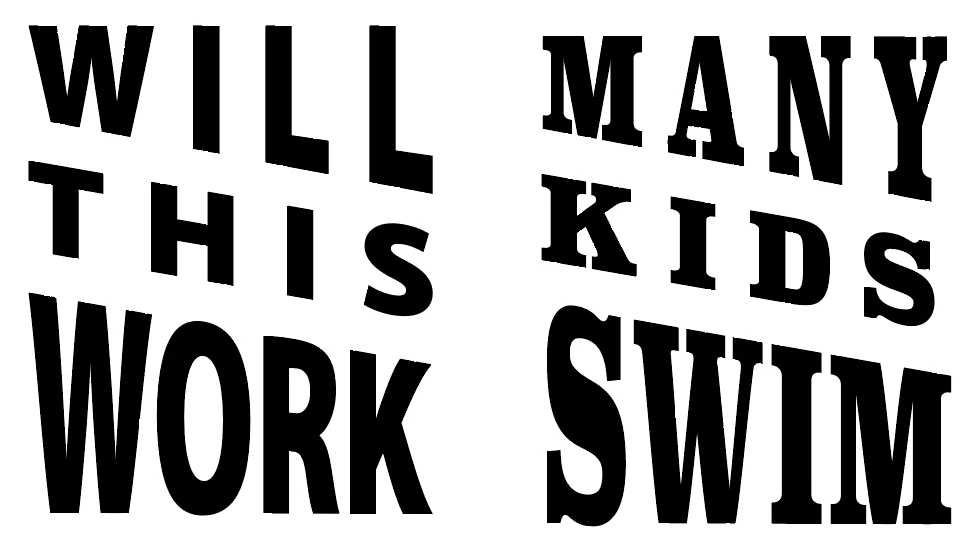

Jacob Bugge
January 22, 2021
kacies,
My first thought was also the effect way suggested by Michele (the middle word/line BIRTH could be made with Shear), but I found it very difficult to get a consistent slant/spacing from word/line to word/line; and I thought that any change of the text would disrupt the carefully built appearance.
So I tried to find an accurate way to do it with outlined Type, and came up with the following to get a consistent slant/spacing from word/line to word/line, which you may find useless (but it was fun to make), see screenshot below of crude work in wrong font:
1) Write the three words/lines (you can make them as one Type instance in three lines) and make a first adjustment of size to roughly give the same width, then Type>Create Outlines and fine adjust to same width (preferably that of the middle word BIRTH) and consistent (vertical) spacing;
2) Select the middle word BIRTH and Object>Transform>Shear (Vertical axis) by a suitable value (9 degrees shown);
3) Select the bottom word DAY and increase the Height downwards as desired;
4) Create a rectangle with the same size (Height) and Align it to the top/centre of DAY;
5) Deselect, then DirectSelect the top segment of the rectangle and apply the same Shear as in 2);
5) is at the bottom of the first column and repeated at the top of the second column;
6) Select 3) and 5) and Object>Envelope Distort>Make With Top Object;
7) - 10) Repeat 3) - 6), only increasing the Height of the word HAPPY upwards as desired, (7) - 😎 are shown as one step).
Click/RightClick to see in larger size, or Click Here to see in Chrome
