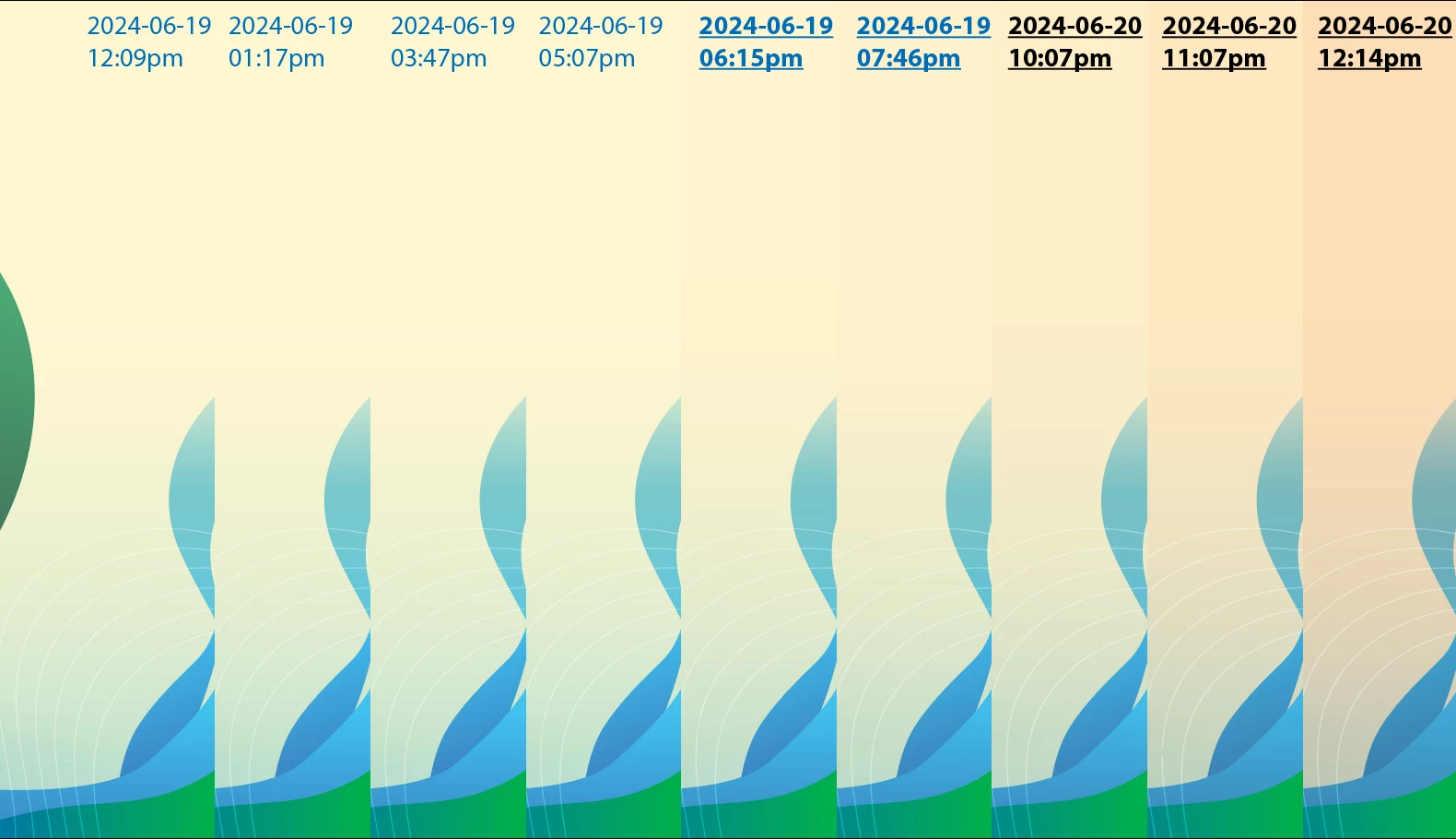

i have same problem, this ai file working on iMac 2013 with macOS 10.15.7 with Adobe illustrator 2020.
I've had this problem for a few years..............

I understand how frustrating it can be to encounter such unusual behavior in your files. I've never seen anything like this in my files. Have you had a chance to try the suggestions shared above?
If it's not too much trouble, could you please share the sample file and a screenshot of your color settings? This will really help us understand the issue better and provide you with the best possible assistance. Thank you!
Srishti
June 21, 2024
Thank you your reply, The questions from"Ton Frederiks" asked me were very insight. i testing now.

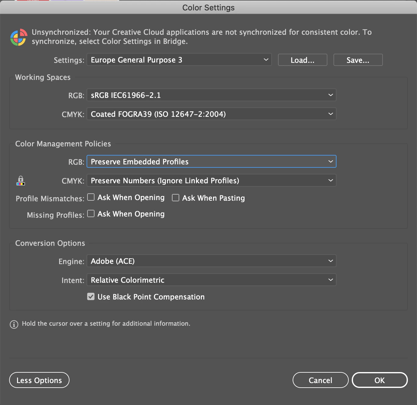

Can you show your Edit > Color Settings?
April 23, 2021
I am having the same issue regarding changing colours - working in RGB and colours keep reverting to a dull tone. Here are my settings..
Any help hugely appreciated. A

I would choose the settings Europe General Purpose 3 preset and turn on the warnings.
Quit Illustrator and see if you get any warnings when you open an existing file.

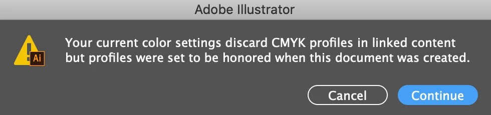

Ok, there's a warning like this:
Ton Frederiks
January 7, 2020
You must have saved the file with the modified settings.
Does your color still change?

I always use the default one, but it's always changing the color.
No, the default one does not preserve embedded profiles, but preserves numbers.

Oh I see now, I think I accidentaly change it when checking the box. But I usually do used the default one 🙂
Ton Frederiks
January 7, 2020
Does it still happen when you reset your Color Settings to one of the default presets?
You may want to turn on the warnings.

I always use the default one, but it's always changing the color. So I checked the profile mismatches & missing profile with hope that I could track the changes but that also makes the setting turn to 'custom' 🙂
