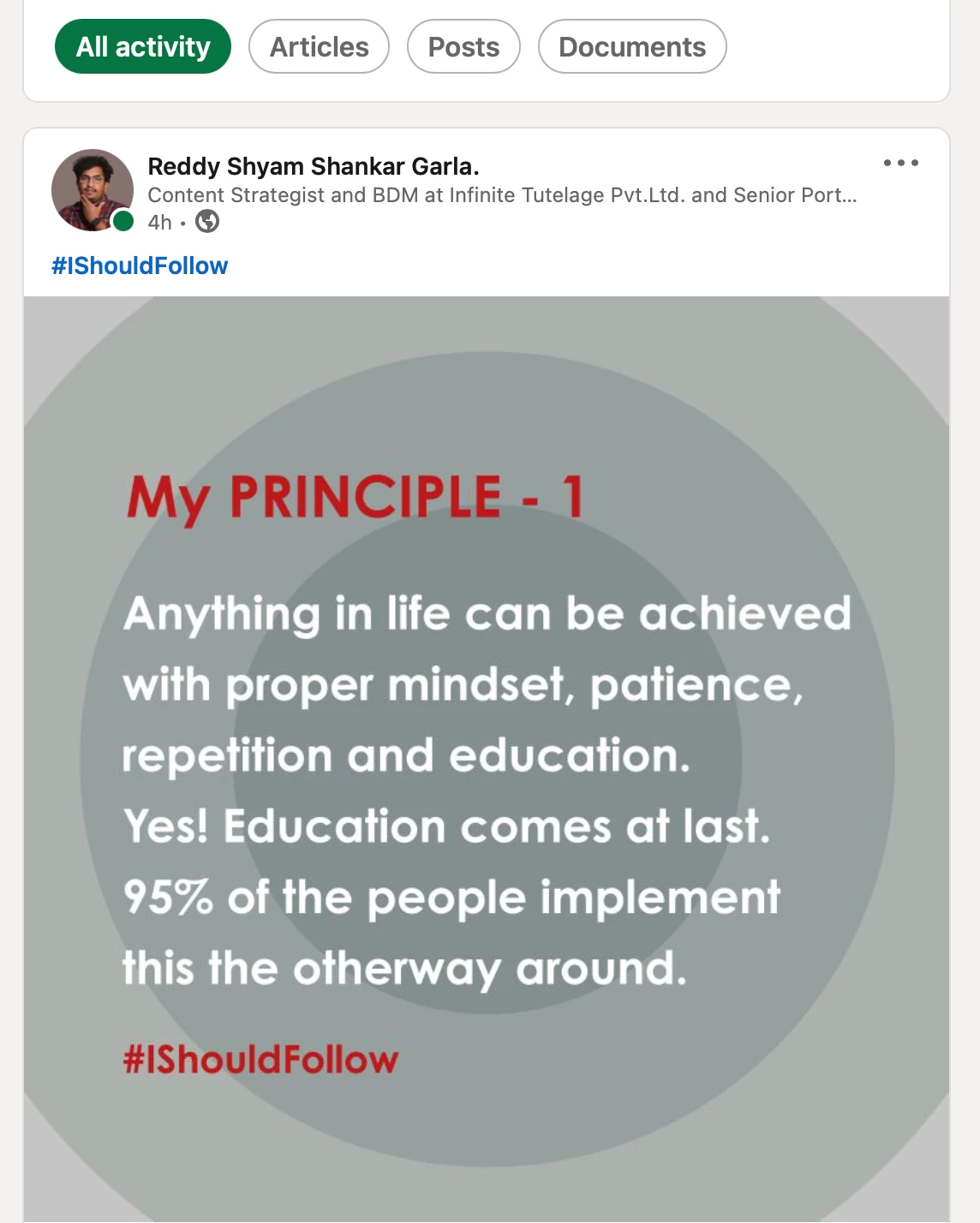

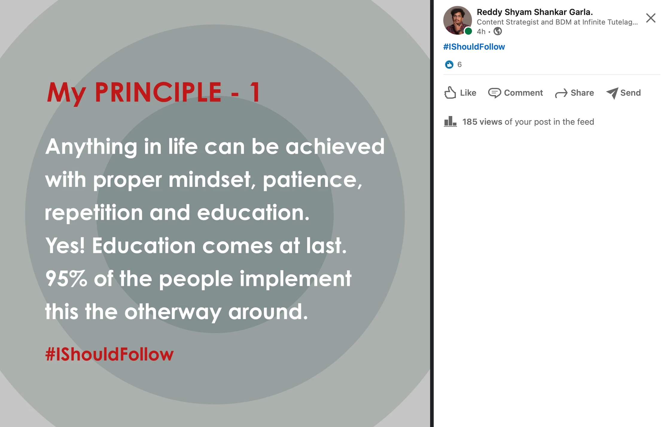

When I uploaded it to Linkedin clarity was not up to the mark that I expected. Please check the below two images.

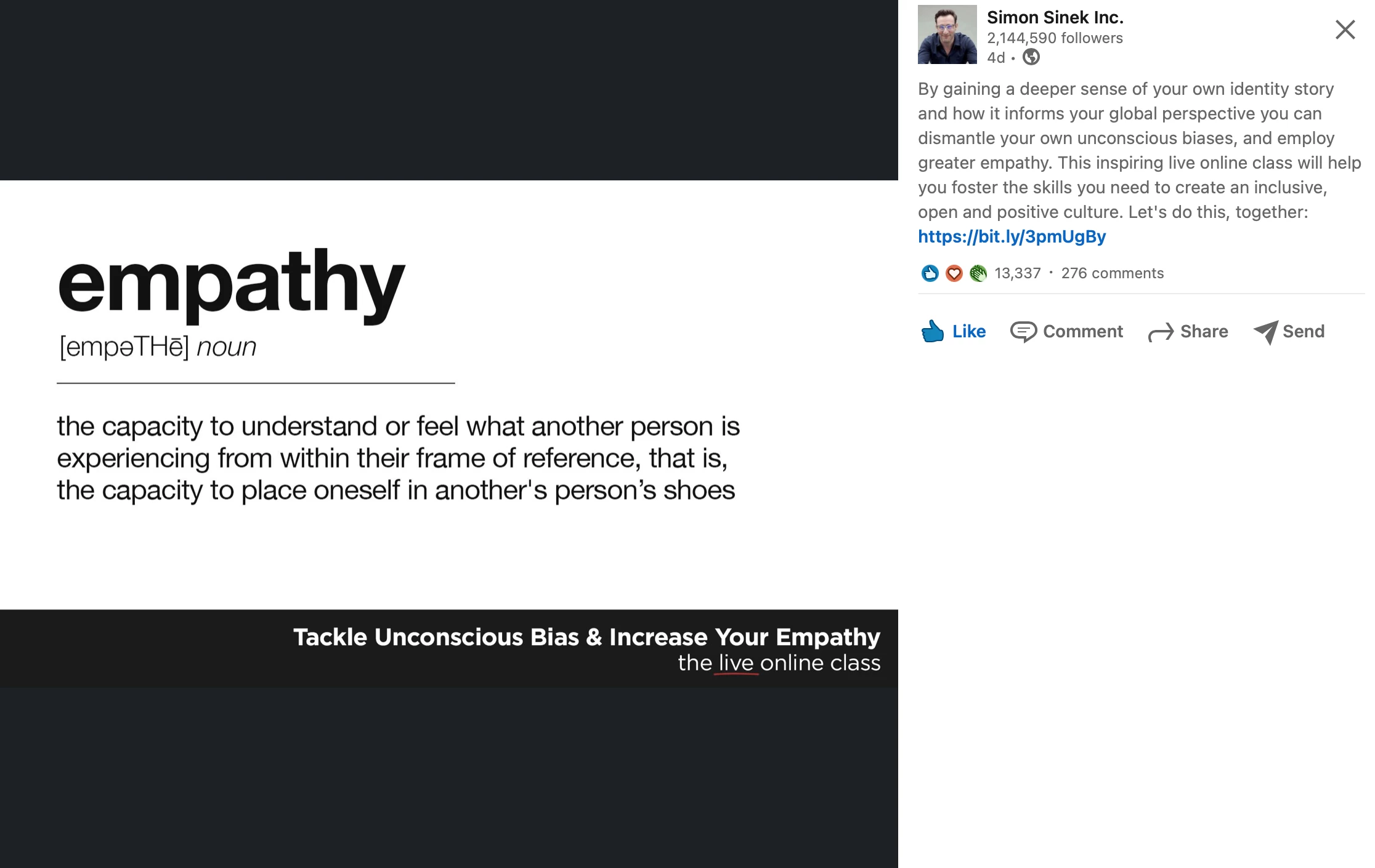

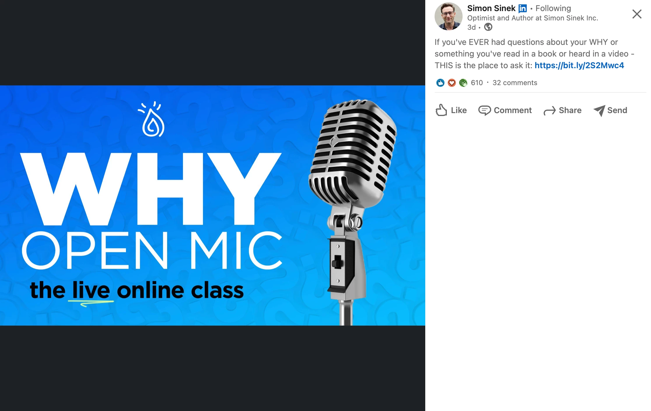

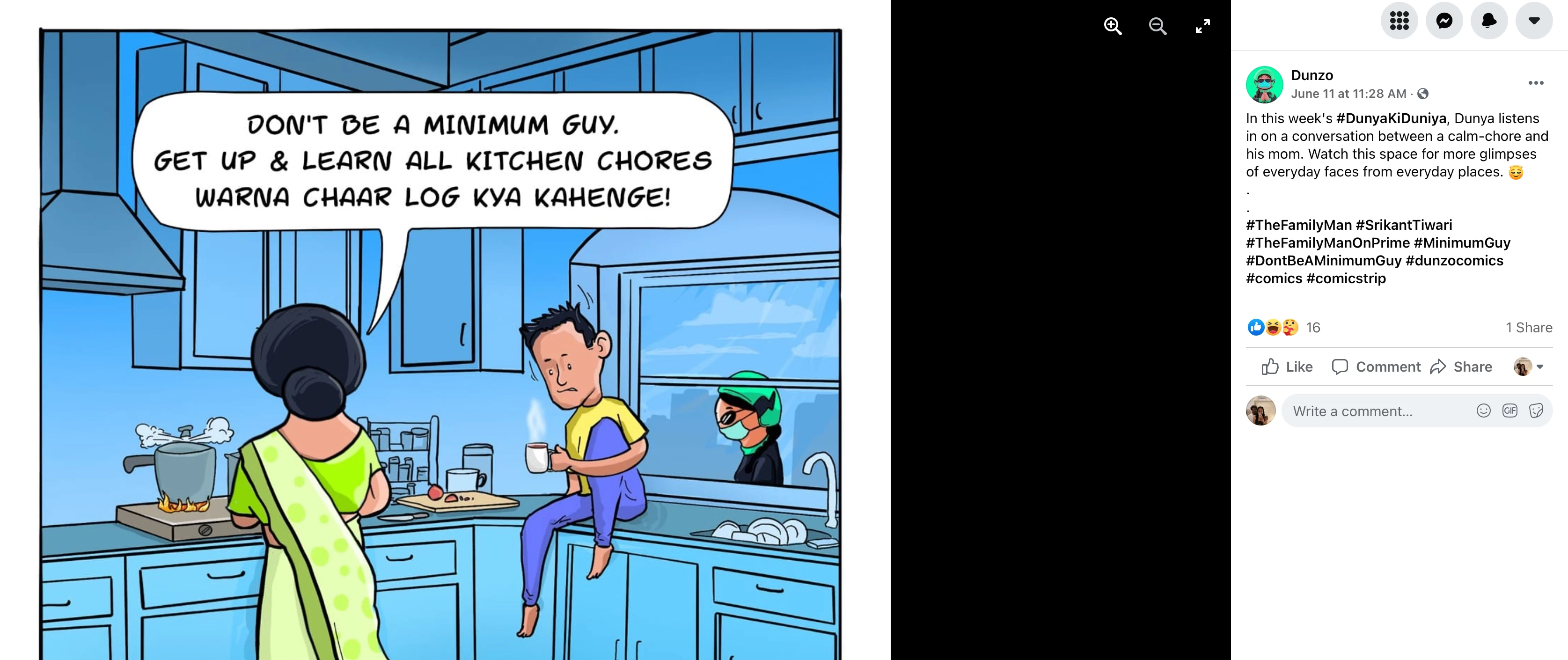

I have been following many pages that post good pictures on LinkedIn and their photo clarity is too good and can sense it. Please check the below images for comparison.

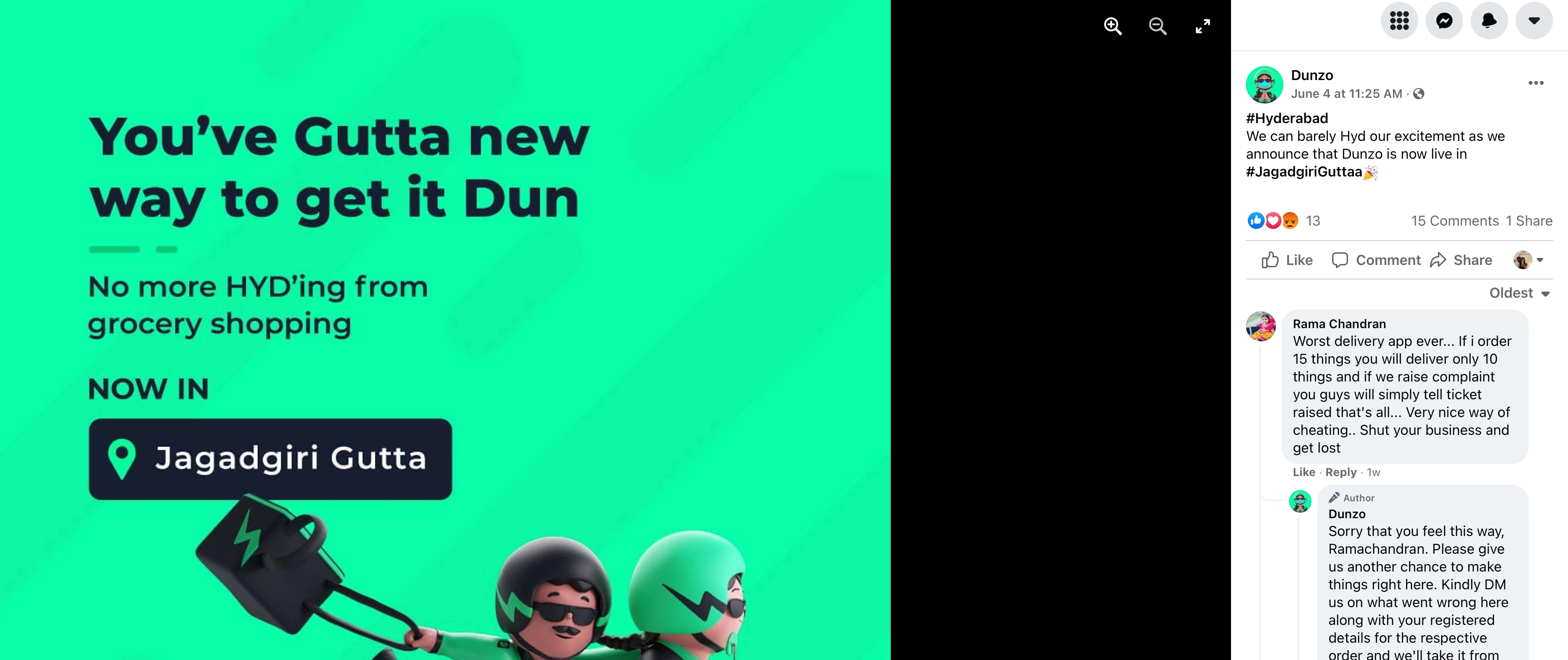

I would like to know why is that? I have tried Facebook with the recommended image size and resolution. I have dealt with the same problem. The other images that I see from other brands are too good. Please check the below images.

All these images actually show the same amount of JPEG degradation. It shows up more on yours because of the contrast of the red and the background colour.
I did a test to see what level of compression they are applying, and it appears they sit kinda in the "medium" range. I did a test on your "good" clean image and it ended up looking exactly the same when saved as JPEG at a quality setting of "6".
As for the 1200 x 1200, I suggest you upload something larger, say 2000 x 2000 and see what happens. the worst is it will be the same as what you are getting. This will force LinkedIn to downsample to fit their needs. Ironically, I find it weird they ask for 1200 in their image specs when their banners are actually 1400 wide. In any case, it's always better to upload more than is needed.

Your images are definitely being compressed. This is causing the artifacts, most noticeabale in the reds.
Sadly, you have no control over how these social media sites handle these files. Facebook, for example, does a lousy job on image compression, so I'm guessing LinkedIn is not much different.
The other thing is: are you sure you've given them a 1200 x 1200 image? Your last image you just posted is actually 1792 x 1790. If that is the file you uploaded, not only is being compressed, it's being downsampled for each use, and, again, their algorithym on that is probably lousy. Have you opened the file in Photoshop to confirm your pixel width/height?

In your examples nobody uses red.
Forget web colors. They are a concept of the 1990ies when monitors could only display 256 colors.

Is the PNG OK when you open it on your computer?
If so then there's nothing you can do. Social Media sites apply additional compression.
Also: please point out where you see issues with the file on Linkedin
