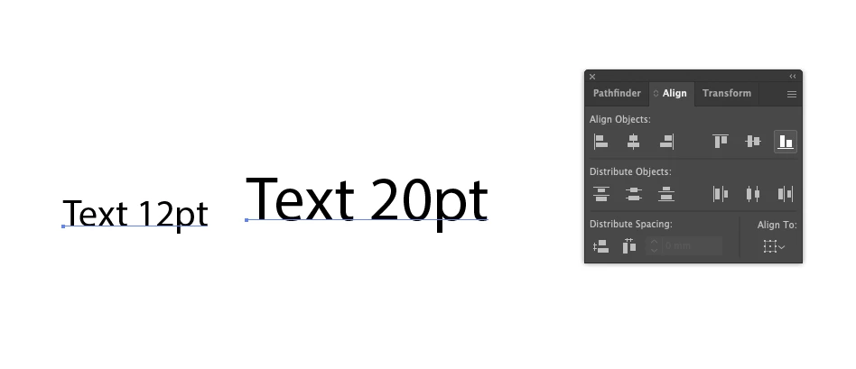

Align different sized text to the bottom of the text baseline
Hi there
I have some difficulties aligning different sized text with the "Vertical Align Bottom" button. Instead of aligning the baseline of the text, it aligns the outlines of the textbox. I have played with "Align to glyph bounds" and "use preview bounds", but nothing seems to work. I also have the feeling that this problem only arose after the update to the new Illustrator version. Does anyone have a tip on how to solve this?

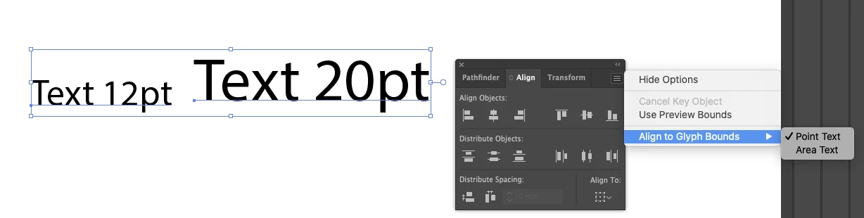

Dec 10, 2020 11:54 AM UTC
The text you have selected is point text. Be sure that there is a check (tick) mark next to Point Text in the Align to Glyph Bounds. It makes no difference to point text whether or not the Area Text selection is active or not, so ignore that; nor, under usual circumstances, does Use Preview Bounds affect the type alignment, so ignore that, too.
Peter
ladinah52427937
Dec 10, 2020 1:03 PM UTC
Hi Peter
Thanks for your quick reply. I tried to check the mark next to Point Text, but unfortunately for me this does not solve the problem...
Monika Gause
Dec 10, 2020 3:46 PM UTC
You can't align to the baseline with the align panel. You can just move the text with the selection tool and then align to the baseline.
