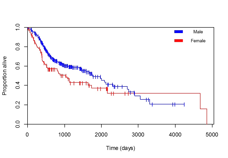

I'm wondering if there's a way for users to align objects to a line with varying heights. For example, I have a line that steps down at various places. Is there a way to align objects with each horizontal segment of the line at different heights? Ideally I would like to center align those objects with the horizontal line segments if possible.

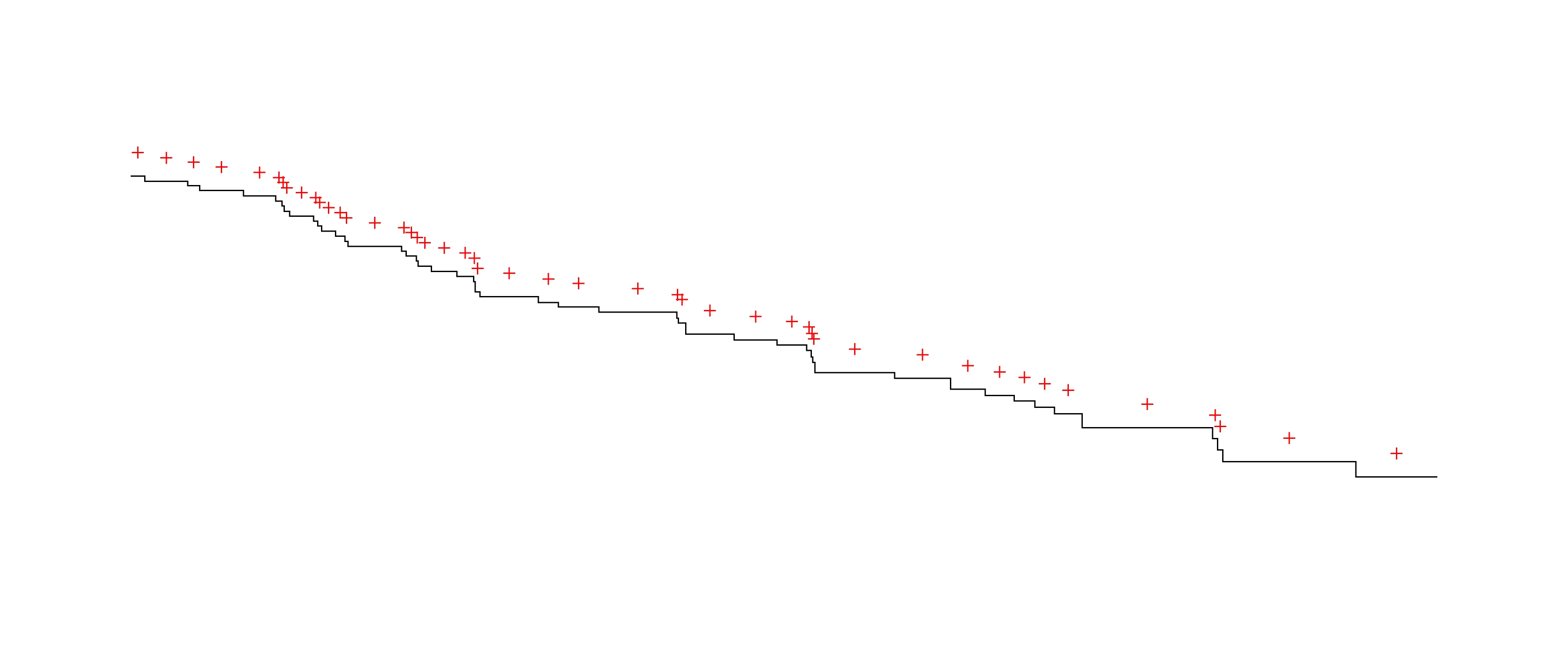

If I understand your request, the script below should get you the desired result (see pic below). I tried to trace your reference path as close as possible for testing. I have also included before and after vector files for you to work with as well.
Looking at your example picture, the path starts and ends on a horizontal segment. With this in mind, the script just iterates over each set of 2 points, determines the center point between, and then draws a cross mark (offset above the path). All cross marks are put in a separate layer and grouped.
I set everything up to be customized, cross color, cross size, and cross offset. See comments in script...
Try the script out and let me know if it does what you need.

NCM81Author
Jul 3, 2024 4:26 PM UTC
Sorry, I don't think I was clear enough. The crosses should be vertically centered on the horizontal line segment below them. Many times, I get outputs from SAS or r (graphing programs) where the created objects don't cross the horizontal line segment it rests on directly in the middle of the object. Thank you for the script, but this doesn't do quite what I need it to. See my reply to Kurt Gold above.

I'm sure Josh Duncan's script actually is what you are looking for. You just have to change line 59.
Instead of
  crossMarkVerticalOffset = 18;
just use
  crossMarkVerticalOffset = 0;
One could also create an action, but Josh's script does it very well.

Kurt Gold
Jun 27, 2024 9:37 PM UTC
Does that mean that something as shown in the screenshot below may be the desired result?
