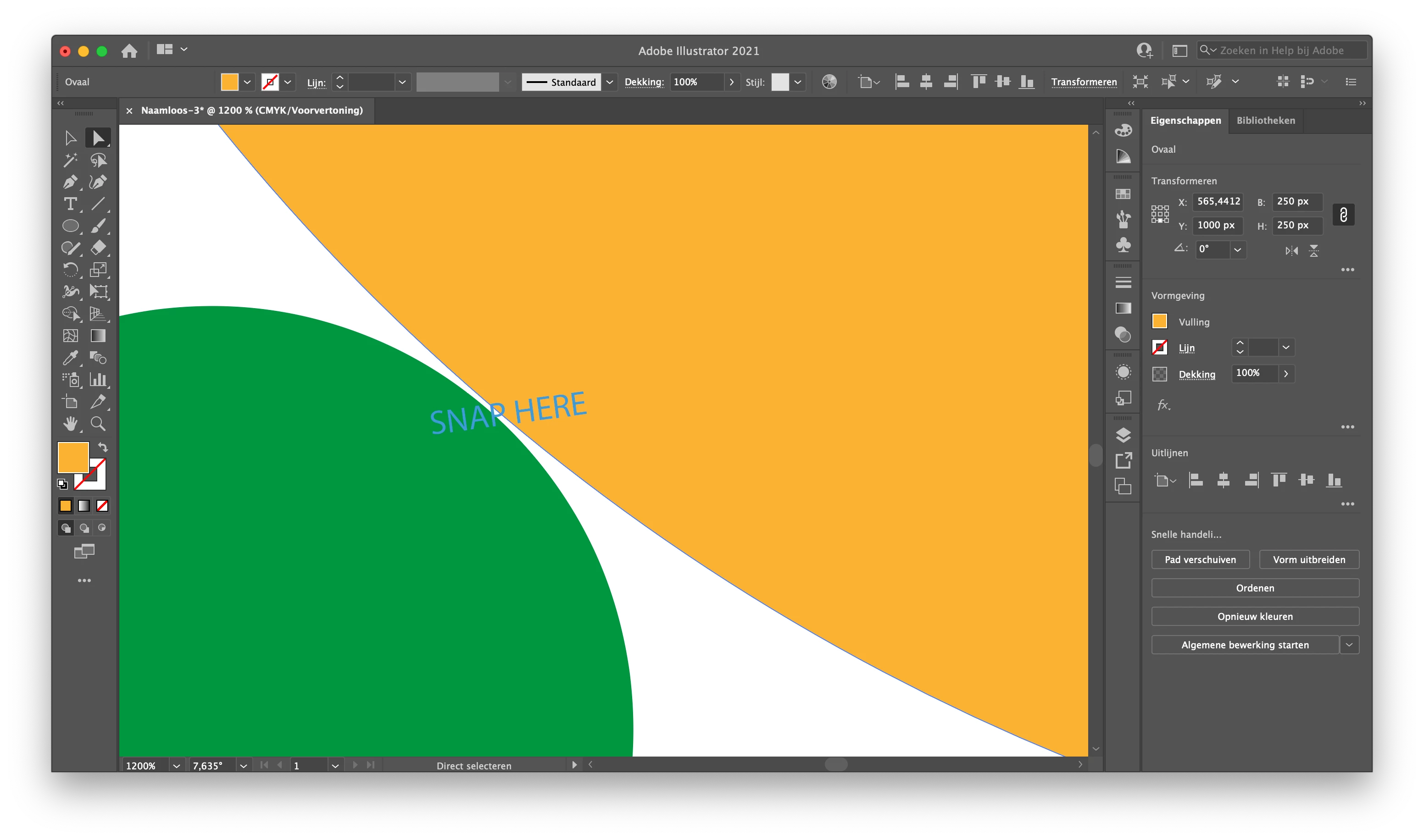

Hellooooo,
Who can help me with the following?
I created two circles one small and one bigger.
If I drag the small circle to the bigger circle this will snap only on the basic smart guidelines.
The result where I am looking for is the small circle under the big circle. I Have uploaded an screenshot to make the question more clear.
I aligned the to circles on the bottom and looking for an option to snap the wo circles to each other. (see the screenshot with the note)
Hope someone can help me 🙂

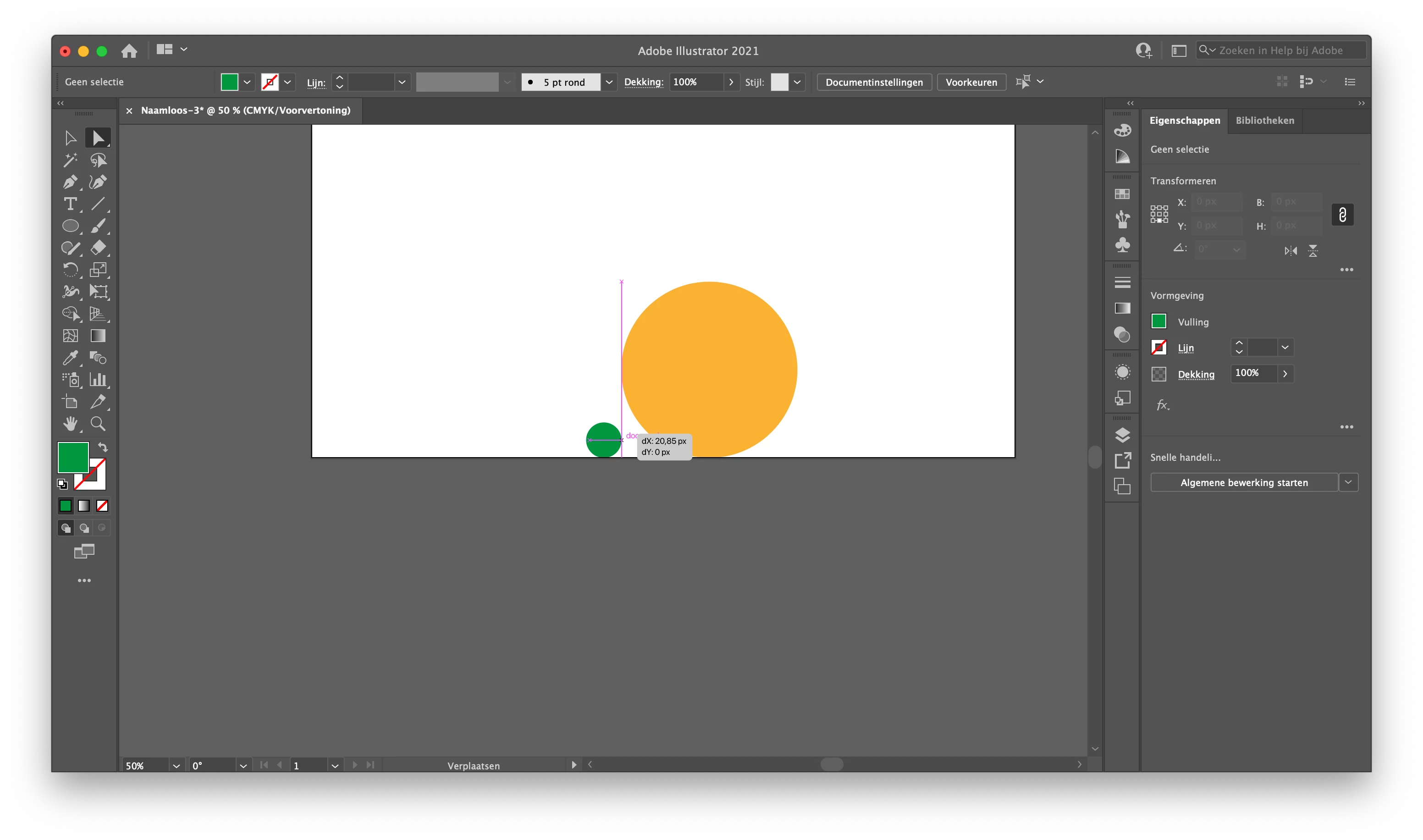

Lieke,
Based on a new reading of your original question, I believe you just need to have the small circle snapped to the bottom of the big circle at some angle.
In that case you can just ClickDrag the small circle by its upper Anchor Point to snap to the bottom Anchor Point of the big circle, and then you can (Group and) rotate the pair as desired; if you wish to keep the big circle in place, you can click its centre with the Rotation Tool before rotating, or if the desired position is just approximate you can just move the pair round as deisred.
And if you wish to have a specific angle between the centres, you can set that angle in connexion with the rotation as well.

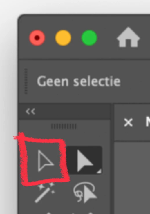

I would do it this way:
  • Use the Selection tool (black arrow), not the Direct Selection tool
  • Deselect both
  • With the shapes deselected, drag the edge of one ellipse until it touches the other
  • Smart guides will tell you when they touch, and the cursor will change from black to white
~ Jane

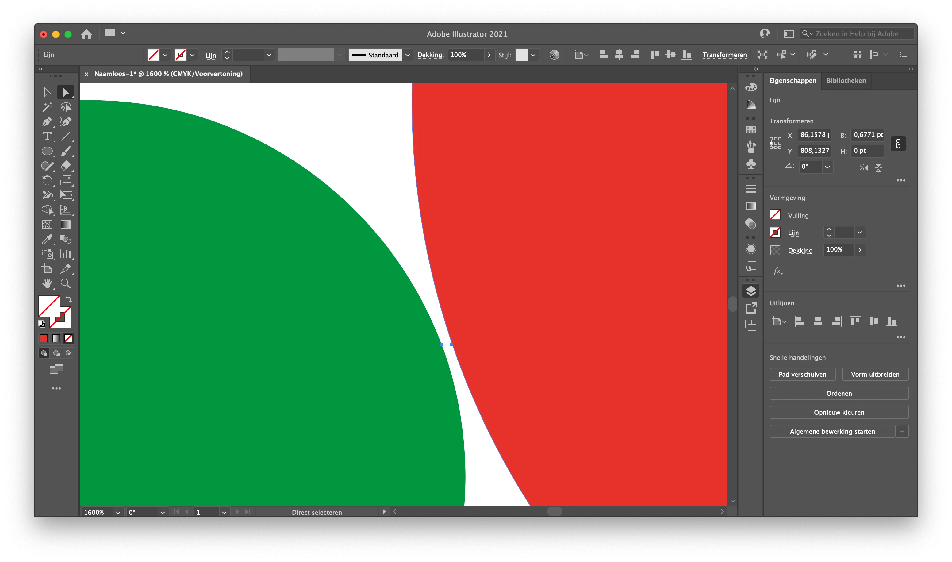

Lieke5EE6Author
June 21, 2021
Hi Jacob
Thanks for the reply.
I do not exactly understand what you mean with the line between the circles and how the smart line can help with this.
See the attachment what I have done.
Maybe you can show me what you mean?
