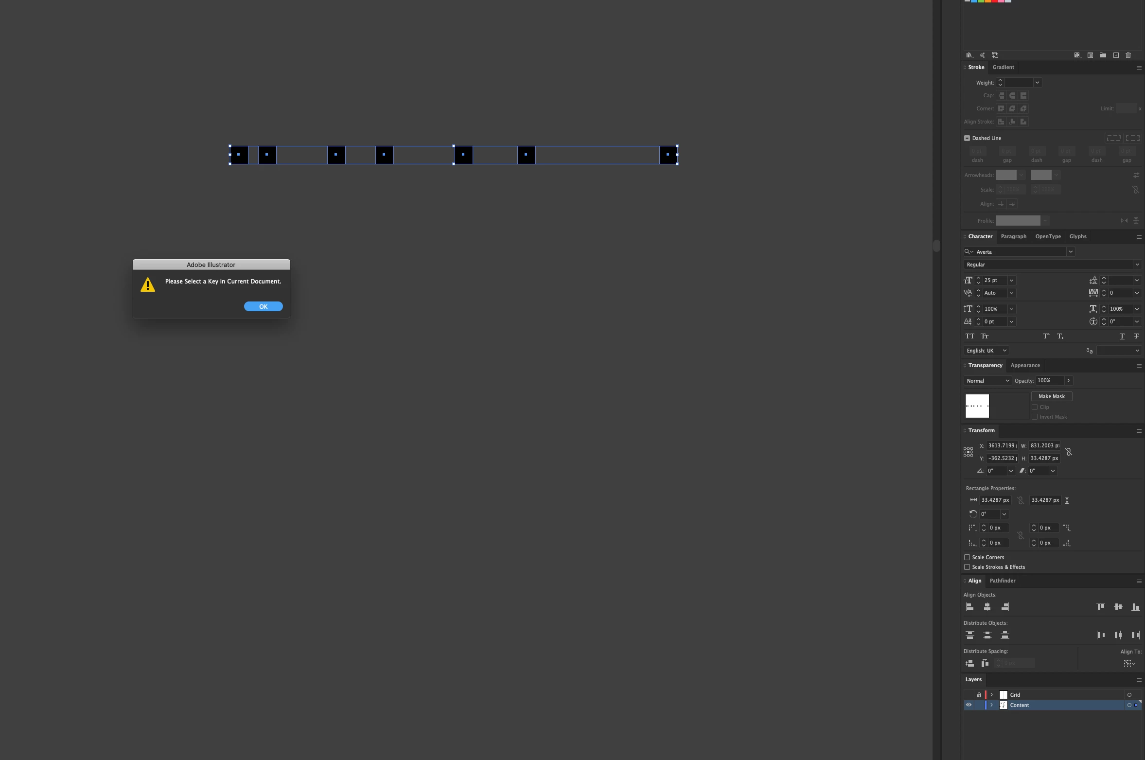

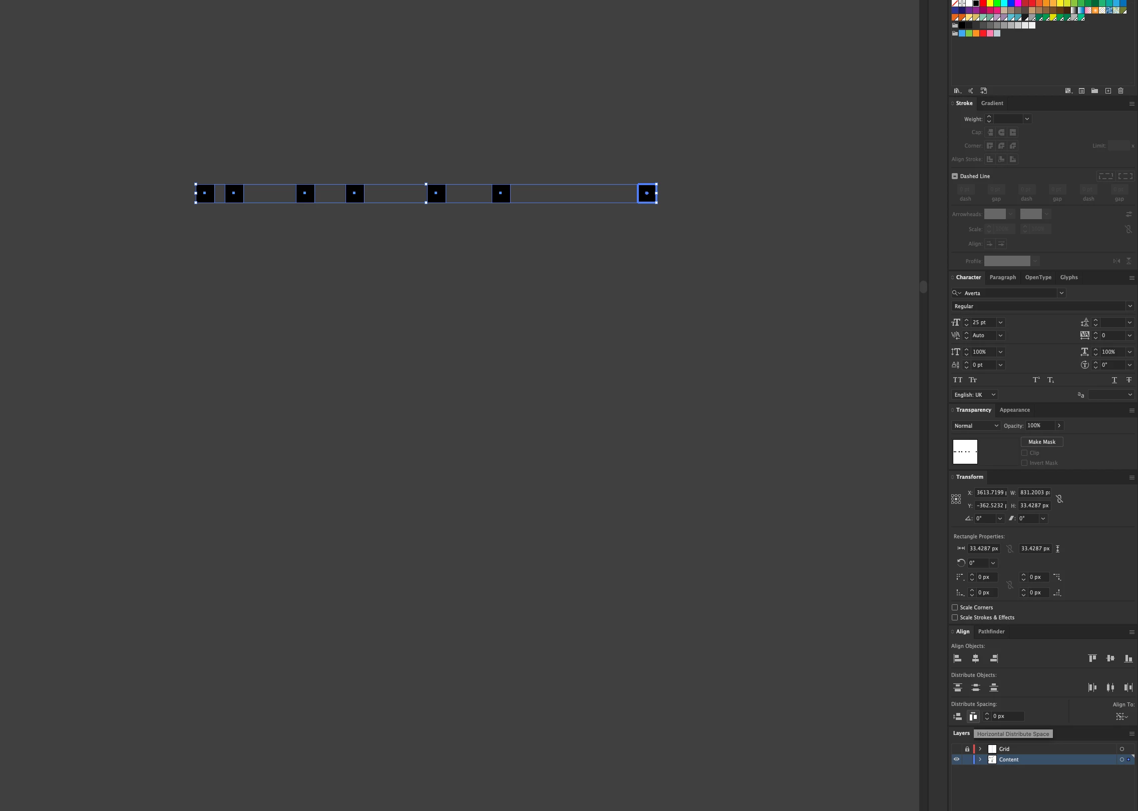

I've just run the new Illustrator update (24.2) and can't get my head around the new 'Distribute Spacing'.
Previously, if I wanted to space elements on my cardboard equidistantly I would select all of them and press the button, this would create equal space between all of them. Now, when I select the elements, one of those becomes the 'key' and when I press the button to space them out - all of the elements shift to the 'key' and sit next to each other rather than spacing equidistantly.
If I remove the 'key' element I get an error message, which says: "Please select a key in the current document."
Am I being a dope and missing something relatively easy or does anyone else have the same problem or even better, a solution?

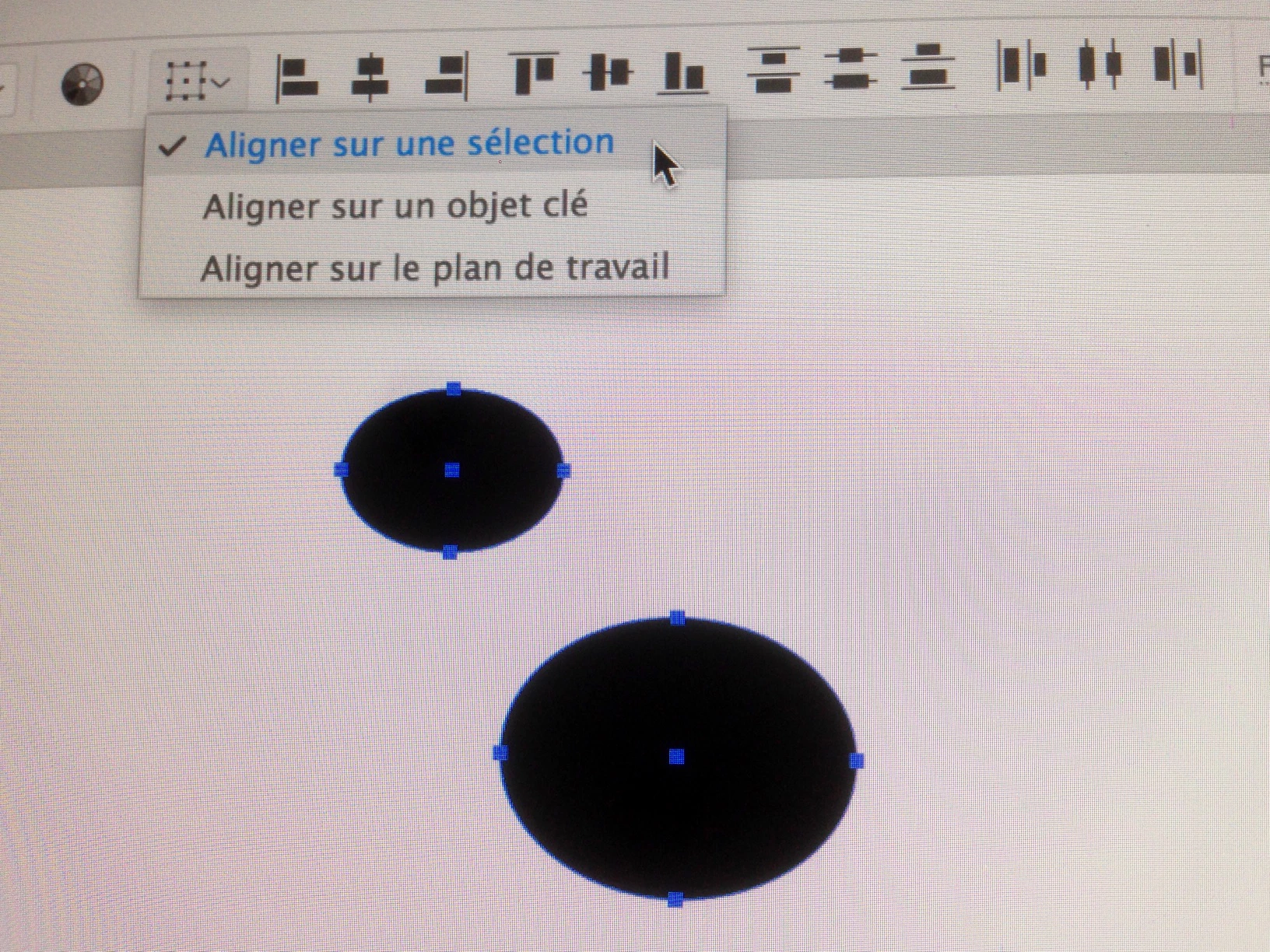

Jun 26, 2020 11:51 AM UTC
Bonjour tout le monde, je suggère sur les futures versions d'Illustrator la possibilité de pouvoir paramétrer par défaut les options d'alignement sans devoir toujours aller dans la boite de dialogue. Là on ne sait jamais trop ce que ça va donner et on perd du temps. Merci ! 🙂
(Hello everyone, I suggest on future versions of Illustrator the possibility of being able to configure the alignment options by default without having to always go to the dialog box. We never know what it will give and we waste time. Thank you ! :))
Charu Rajput
Jun 26, 2020 11:59 AM UTC
This is a bug in latest version of Illustrator. Team is working on it.

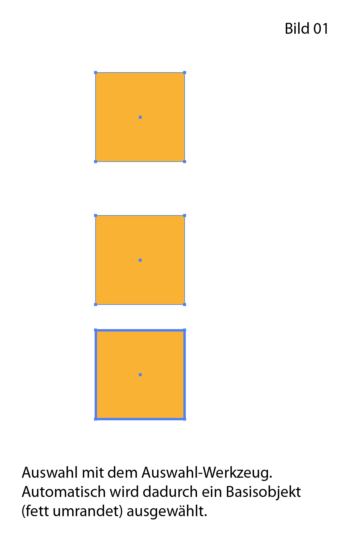

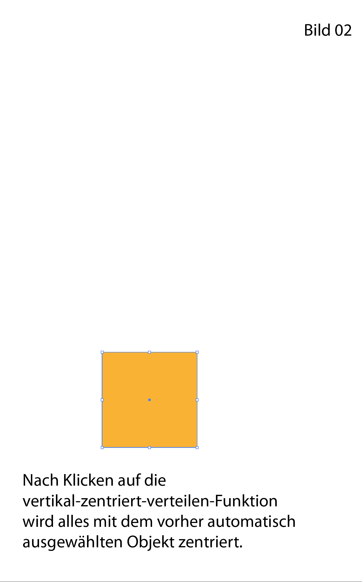

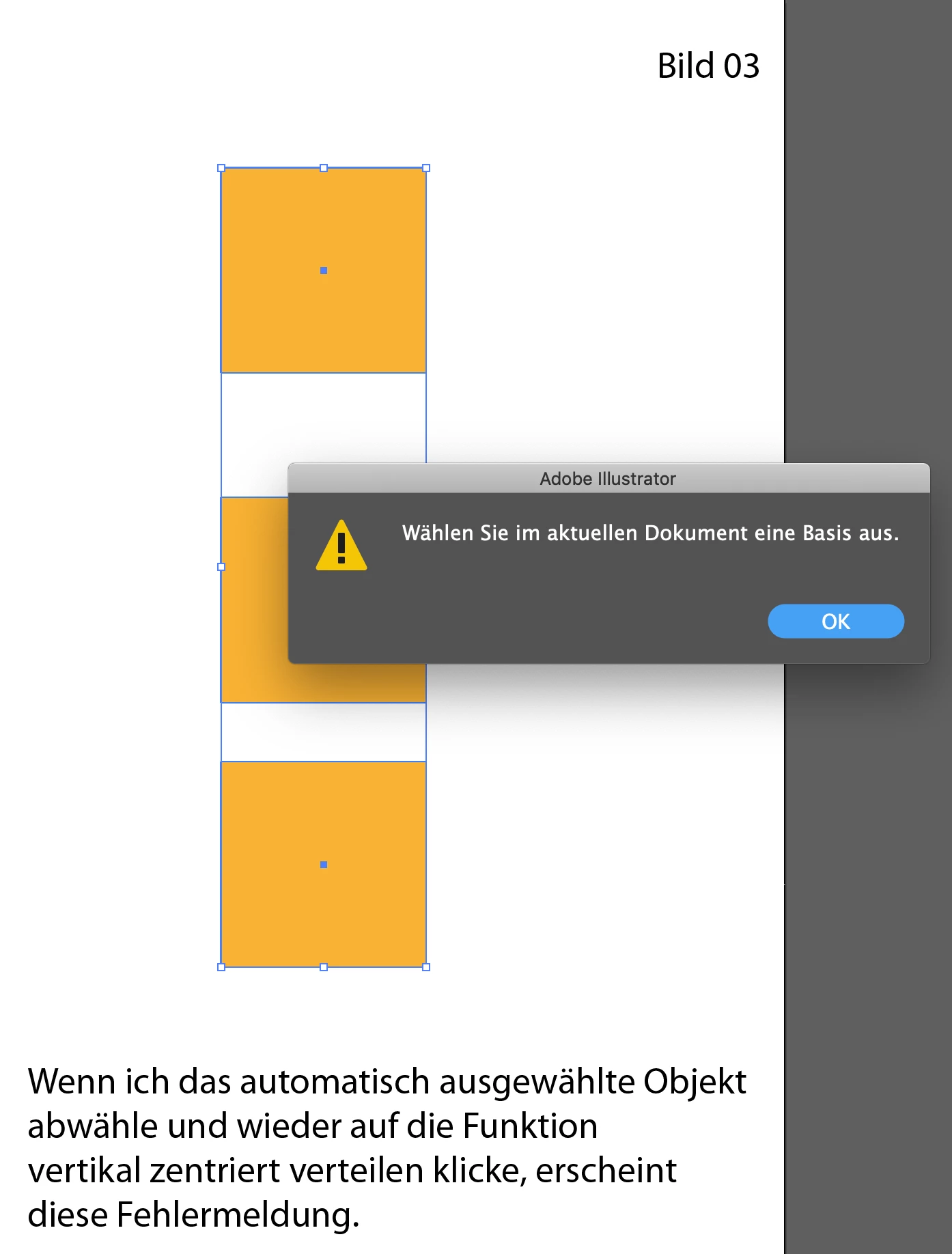

Hallo zusammen,
seit dem Update auf die  Version 24.2 funktioniert bei mir das Werkzeug vertikal zentriert verteilen der Palette Ausrichten nicht mehr. Hat jmd. ähnliche Erfahrungen? Vielen Dank.
Jun 26, 2020 7:34 AM UTC
Check first that Align is to Selection not Key object or Artboards, as it selects those other options by default.
If it does not the job, please attach an example  before/after. Thanks.
Jun 26, 2020 8:27 AM UTC
Thank you for the Reply,
I am not quite sure, wether I understood correctly … the problem occurs with the horizontal zentriert verteilen-Tool, too … attached, as requested 3 examples. Thank you!
