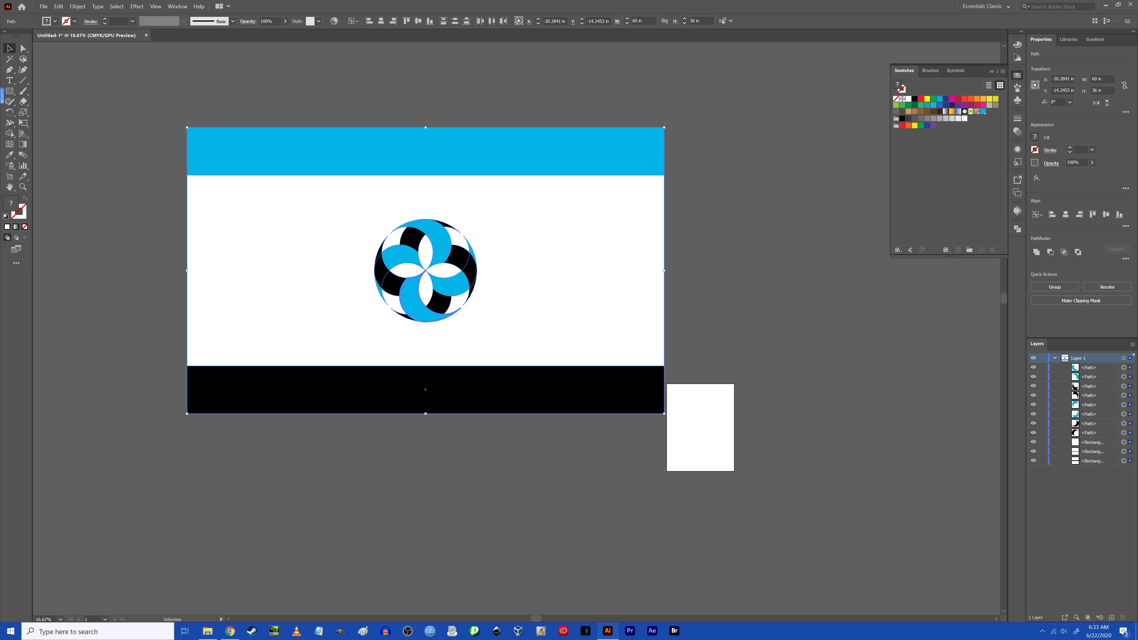

Jun 22, 2020 10:37 AM UTC
Whenever I drag select all the objects on my piece, a certain object always has a special thicker blue outline for some reason, and I'm not even using the Direct Selection tool. It's kind of annoying since I'm pretty obsessive when it comes to stuff like this. Is there any way I could possibly minimize this or something? Thanks.
Monika Gause
Jun 22, 2020 4:32 PM UTC
That's a bug with the Align function. You need to set the Alignment to "Selection". It should then stick for the rest of the session. But also the developers are working on it.
Jun 26, 2020 12:28 PM UTC
Thank you so much! 🙂

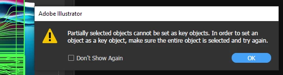

Jun 19, 2020 6:43 PM UTC
I am getting this message when trying to select points on a mesh object. not trying to align just select a group using select arrow so i can move them. Bug?
Monika Gause
Jun 19, 2020 9:30 PM UTC
Version 24.2? Yes, there's a bug with ALign. Can you try and in the Align panel set the option to "Align to selection" instead of "Align to key object" before making the selection. Does that work?
Jun 19, 2020 10:15 PM UTC
yes that allows me to select...odd though since i wasnt trying to align anything

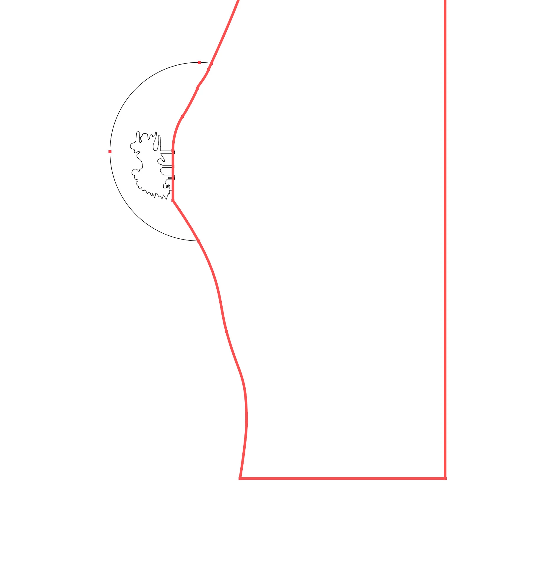

Jun 19, 2020 12:36 PM UTC
Does anyone know why/how to stop this happening...
Every time I select more than 1 object, one of the objects path turns solid and the anchor points disappear.
Show anchor points is on, show edges is on.
Monika Gause
Jun 19, 2020 1:04 PM UTC
That is an issue with the align feature. The team is working on it. In the Align panel turn off the "Align to Key object" option and set it to "Selection". Should be sticky for the rest of your session.
Jun 19, 2020 2:12 PM UTC
Thank you!
