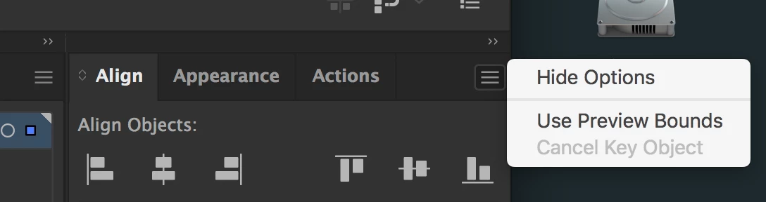

If centering the two circles is what the OP is looking for, then unchecking Use Preview Bounds does the trick for me. Great thought MikeGondek.

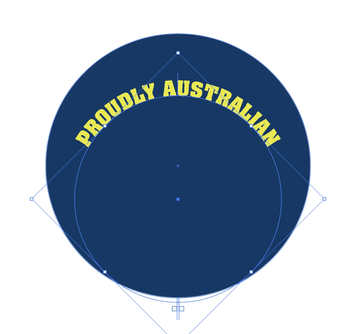

Your problem is your bounding box is rotated like this
You need to: object >> transform >> reset Bounding Box
Then also make sure you have use preview bounds unchecked

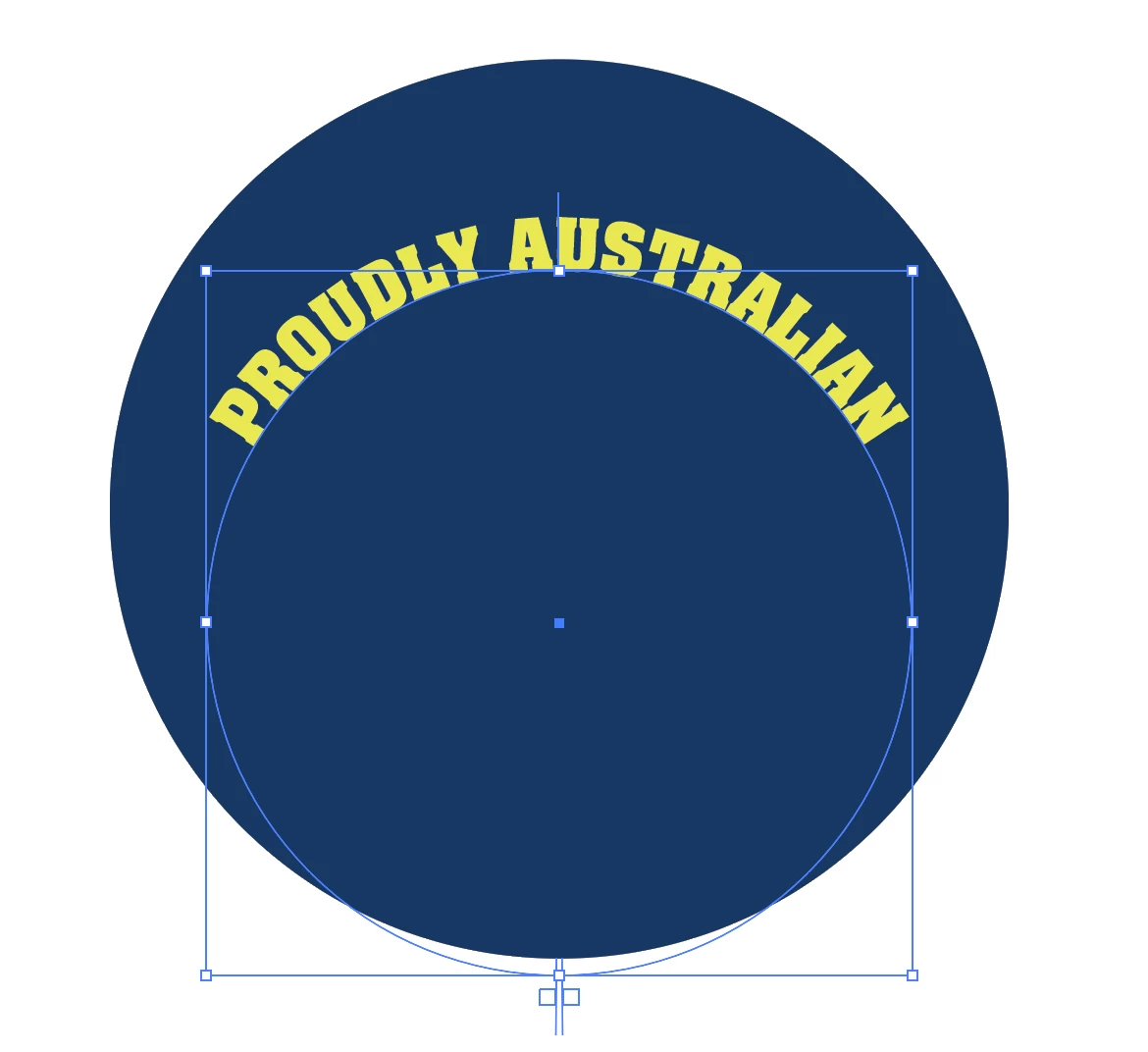

In watching your video, I believe there is NO problem.
What you're not taking into consideration is that the Align panel is NOT just centering the two path to each other. In the Type on a Path object it is including any type when it centers the two objects. (The type is part of the Type on a Path object.) If you delete the type and try centering the two objects again, they center perfectly to each other. If your type goes all the way around the Type on a Path object it will center to the other circle quite well. But if the type around the top of the path is a larger point size, Align will include that larger type in the way it is centering.
