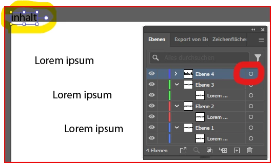

Selecting a TextFrame created in the script does not work as desired.
This is the code used:
var myDoc = app.activeDocument;
var topLay = myDoc.layers.add();
topLay.name = 'LABEL';
var txt = topLay.textFrames.add();
txt.name = 'LABEL Text';
txt.contents = "inhalt";

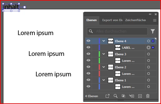

topLay.textFrames[0].selected = true;
Result (text frame seems to be selected but is not)
Possible remedies after some quick tests:
1)   (Because it is only the only element in the newly created layer) Change the last line to:
topLay.hasSelectedArtwork = true;
works right away in this case.
2)  If the document is closed and reopened in the script, the TextFrame can also be selected correctly (this was only a test, however, as it is not practical).
3)  If the selection is deselected in the script and then called up again, it works without any problems.

Can you understand this? Do you have an explanation for this?

I'm now assuming that the script problem is due to the delay in updating the layer panel. New layer is empty, then TextFrame appears in it, new layer is collapsed. The script knows that the TextFrame already exists, but Illustrator does not "see" it in the new layer. We need to redraw the screen:
1) app.redraw() - it will enlarge the document history (X)
2) call some event on the screen before selecting an object ()

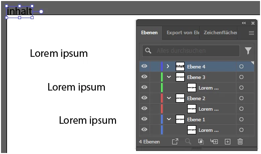

We can also observe a funny bug when we place TextFrame in the selection array. The bounding box around it will appear on the artboard, but it will not be highlighted in layers, i.e. the object is still not really selected.
app.selection = [topLay.textFrames[0]];
