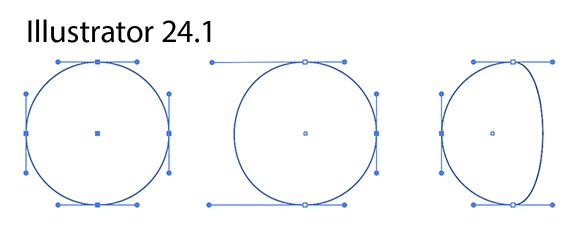

There are more unexpected results when removing anchor points in 24.1
This is an example in 24.1 of a circle with a left or right anchor point removed.
Removing the left one gives a surprising good result, but removing the right point gives the result as in previous versions

Thanks for reporting this issue. We are able to replicate it at our end and it is currently under review. I'll share an update as soon as possible.
