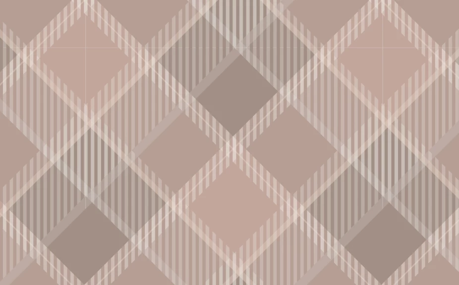

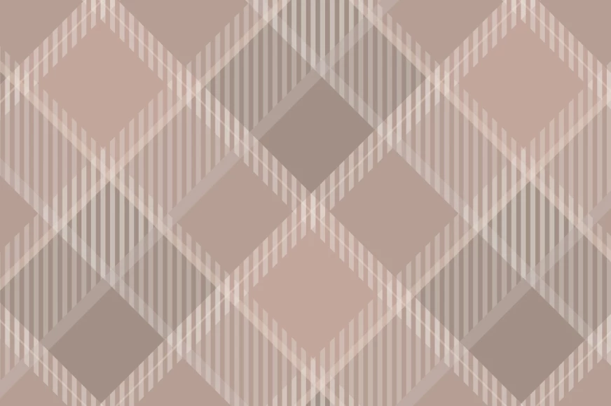

After updating to 29.2.1 it's super fast to export to jpeg, but now it exports my patterns with lines and spaces (patterns seams amd sometimes random lines) that weren't there before. I think the update broke something 😞
Pictures show same .ai file exported to jpg before and after 29.2.1. (same settings)

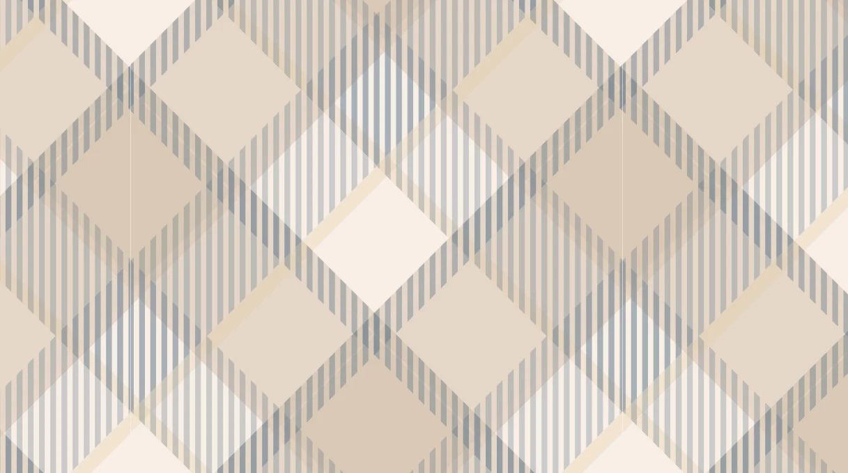

Same pattern, different colors - different lines appeared

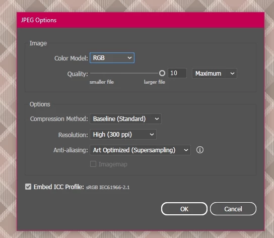

I Export As jpeg

I do exactly as I used to do before the update and now it's not working anymore. I did test exporting old files that I had previously exported to compare and they're showing the lines when I export again.
