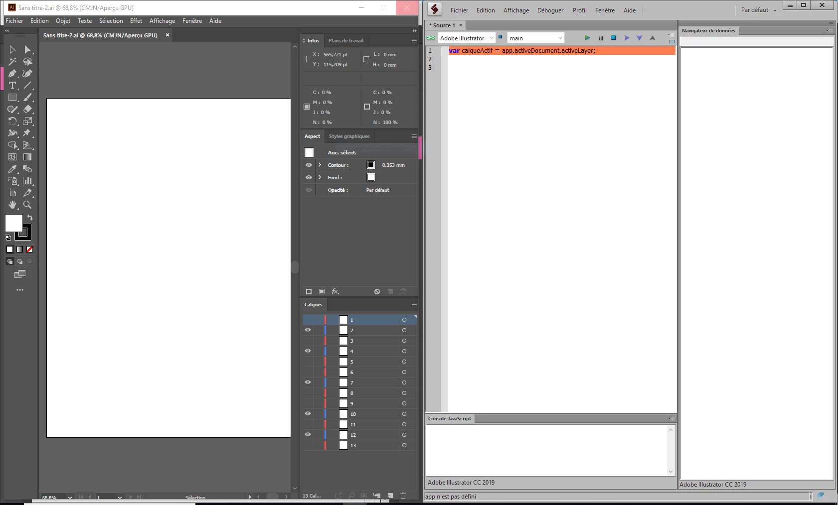

I am learning scripting for Illustrator and I have some problem, when I use ExtendScript, I have an error sometime : app is not defined.
I have to close Illusatrtor for continue to work with ESTK, do you have a solution, please?

Another way to accomplish the provided error is to use the "Reset" button under the "Debug" menu item. Do not press this button as it will erase all of your memory objects and the only way to bring it all back as far as I know is to restart Illustrator.
Even if you had never pressed this button, I suspect the issue is caused by the same reason: your "Data Browser" panel in the ESTK appears to be empty of all variables. Usually you should see a long list of constantly-existing necessary global variables in this panel, among which is the pre-defined 'app' variable.

Aaah maybe, I use this button, ok I think it's reason app is not defined after it.
I will stop to use "reset"

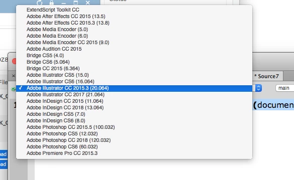

I expect to see a more complete Application Name in the "link" pull-down menu.
Check to make sure you have your current application selected. My list is quite long and the wrong app could easily be chosen.

Hello, I have Illustrator CC 2019 only thus It's ok for it, I have checked it but app is not defined sometime.
I broke link between Illustrator and ESTK too but no good results.
