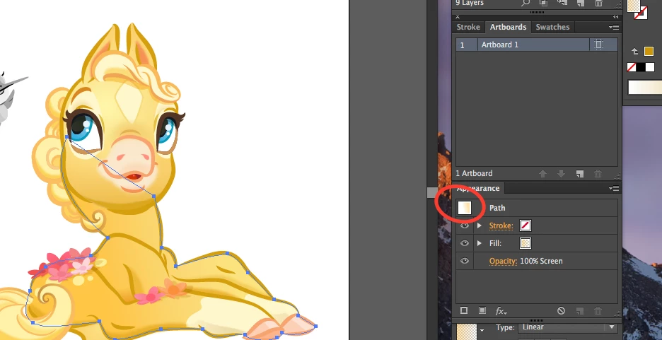

Why can't I see the selected object in the Appearance Panel?  It was there earlier~then I did a freelance job and now it only reads as a tiny box.  I rely on this picture to help me navigate a sophisticated building of a color base (in this case, golden yellow), then a multiply object (shadow), then a screen object (highlight) to swap colors for another character color option.  How can I get that shape back into the Path window?  Thanks~
Correct answer rcraighead
Appearance Panel does not show a preview of the selected artwork, only a rectangle with the current attributes applied.
Try the "Transparency" panel (Show Option) to get a preview of the selection.

LePardine
LePardineAuthor
March 2, 2018
Nope; definitely not confusing it with the Layers panel; altho I use that quite often also.
During the winter months I've relied on the thumbnail of the object selected to appear in the Appearance panel to check to see if I have selected the color base object, or the multiply or screen object.  There should be a thumbnail of that selected shape; now all I get is a tiny box which is hard to see what is selected now~where did that thumbnail go?
Thanks~
Ton Frederiks
March 2, 2018
I can see a very tiny preview when effects are applied, but generally too tiny to make sense.
The selected object and the info in the appearance panel makes more sense.
