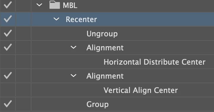

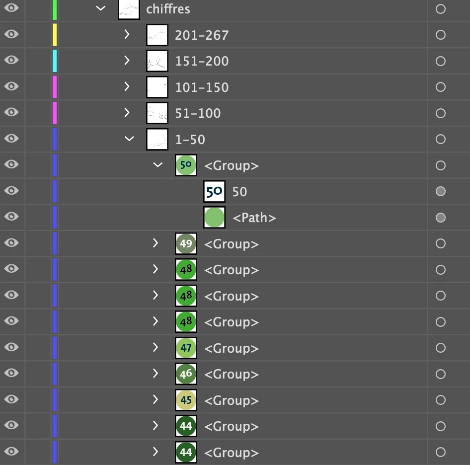

Each sub-layer (might be an object, I am not sure) is a group made of a type element and a shape. A number inside a colored circle. The action simply ungroups, aligns them to each other vertically and horizontally, and re-groups them.
The action:
A sample of the layers panel
