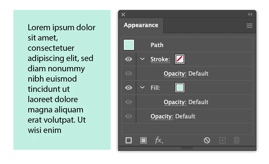

Correct answer Ton Frederiks
If you use the Direct Selection tool to select the text frame (just click first outside it before selecting), you can change the frame color.

Ton Frederiks
Ton FrederiksCommunity ExpertCorrect answer
March 4, 2024
JuurAuthor
March 4, 2024
Omg, this is it. But how come and why it's not visible in the Appearance panel when just selecting the whole Area Type object? Anyway, thanks a lot for a quick response!
Ton Frederiks
March 4, 2024
Good to hear that helped.
IT is visble in the Appearance panel when you direct select it.
