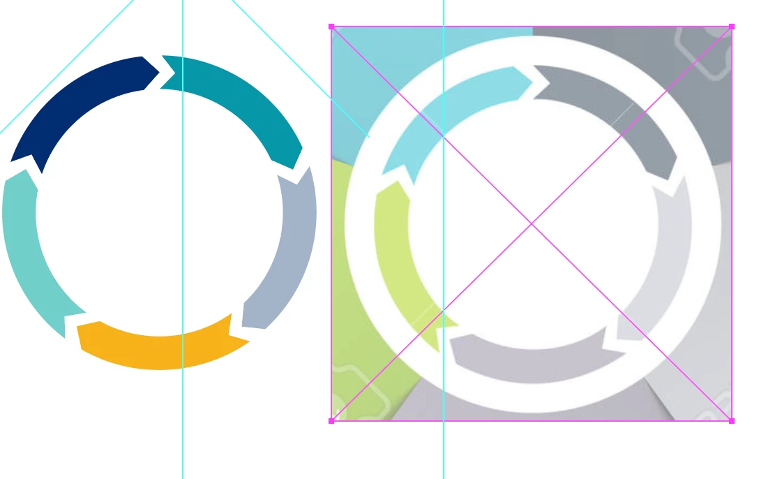

Arrows on an elipse
In trying to draw a circle of arrows like the attached jpg, can't work out how to add, accurately, the start and end arrowheads (as the style shown) to create the first one? I've experimented with arrowheads on the Stroke palette and tried outlining the stroke then adding new anchor points but it's all by eye and, therefore, very hit and miss. I do understand how, once the first one is created, how to duplicate them round the elipse.
Grateful for ideas, anyone.

So the eventual solution was to draw a circle to the same size as the png template and then increase the stroke thickness to match. Using the Scissors Tool, cut the first arrow segment to match and then, outlining the stroke, add anchors points to create the Start and End arrowheads before using the rotate tool to duplicate all 5 arrows. It's a bit fiddly and works well enough but, undoubtedly, there's a better method out there.

Dec 17, 2024 1:09 PM UTC
Draw this in a straight fashion and then create an art brush from it and then apply that to a circle.
