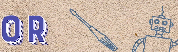

I'm making various web ads with art that started as vector. Art looks great in illustrator, but no matter what I do, no matter what options I select, the final exported art is blurry at 72 dpi. I've tried starting over from scratch in Photoshop instead, thinking it had something to do with Illustrator's export options, but that art is coming out blurry as well. Just makes no sense to me as even the vector elements are exporting blurry.
For instance, for the 728 x 90 px ad, I have a JPG background texture (texture, original file is hi-res), text, vector art, and vector logo.When exported at 300 dpi it all looks great, but obviously that's too large a file size for web ads so I can't use those. When downsized to 72 dpi it's all crunchy garbage.I've even tried completely deleting the background texture to see if that's causing the problem, and the text and vectors still export blurry. I've attached files to show the difference between the 300 dpi file and the 72 dpi file.
