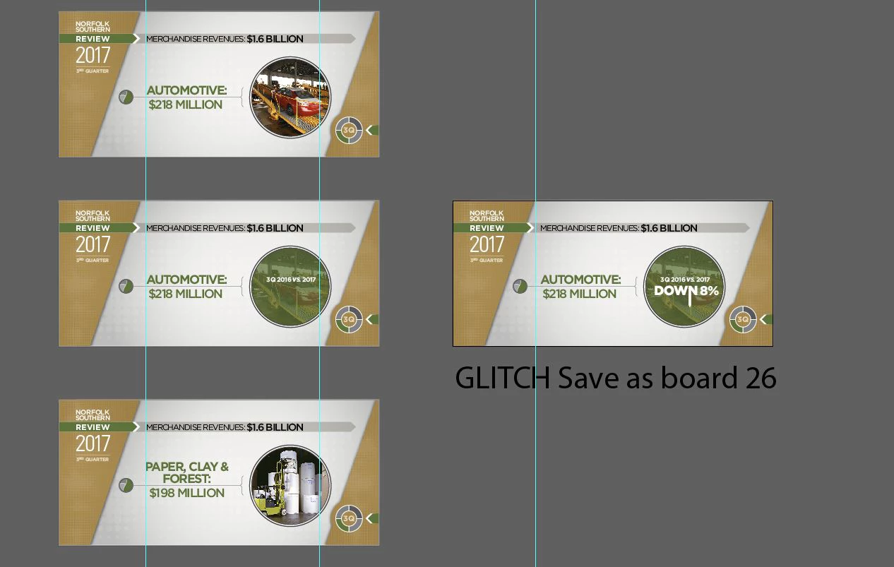

In duplicating artboards  in Illustrator in Windows 10. Select Alt and drag to create a new artboard NO problem. My artboards go from 25, 27, 27, 28. I cannot get a 26. I have created a new artboard at the end and even tried to move it between 25 and 27 to create a 26 and Illustrator will not do it. I still get two 27 artboards. SO the secondary 27 will not export. I have to create one at the end and rename it. I've done this for years, WHAT is going on??? It's a glitch and how do I fix it?

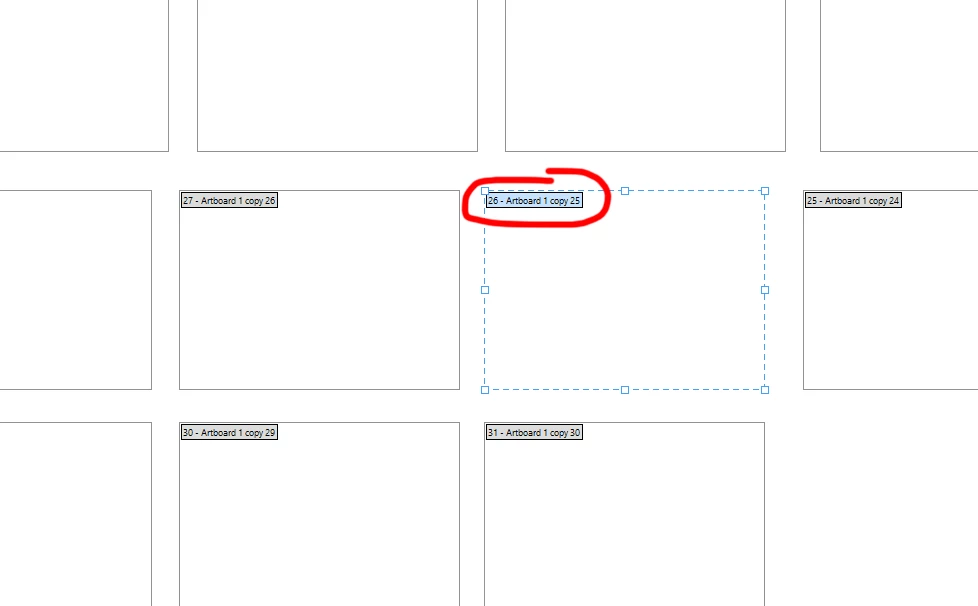

Jul 7, 2021 8:39 PM UTC
Been having this issue  for years. The screenshot attached are examples all from a single file I am working in right now.  Close and reopen the file and the duplicates stay there, but if my coworker does the same on his computer they don't show. Makes no sense. If I try to export it ignores the second artboard of the same number and that art doesn't get exported.

I am experienceing this issue as well. For me numbering goes ...14, 16, 16, 17...
Deleting, recreating, and reordering artboard does not solve the issue.
The issue is limited to the user interface (artboards pallet, and upper left coner of artboard selection).
The first 16, which should appear as 15, will be recognised properly as 15 when 15 is specified in the page range when saving a PDF or printing.

Monika Gause
Oct 31, 2017 4:15 PM UTC
Please show.
Please do also show the artboard panel.
Oct 31, 2017 6:22 PM UTC
I tried renaming the second 27 and it would work - the only thing that would was to create one at the end (#44) and save it as number 26. It would NOT automatically change it and/or save it.
