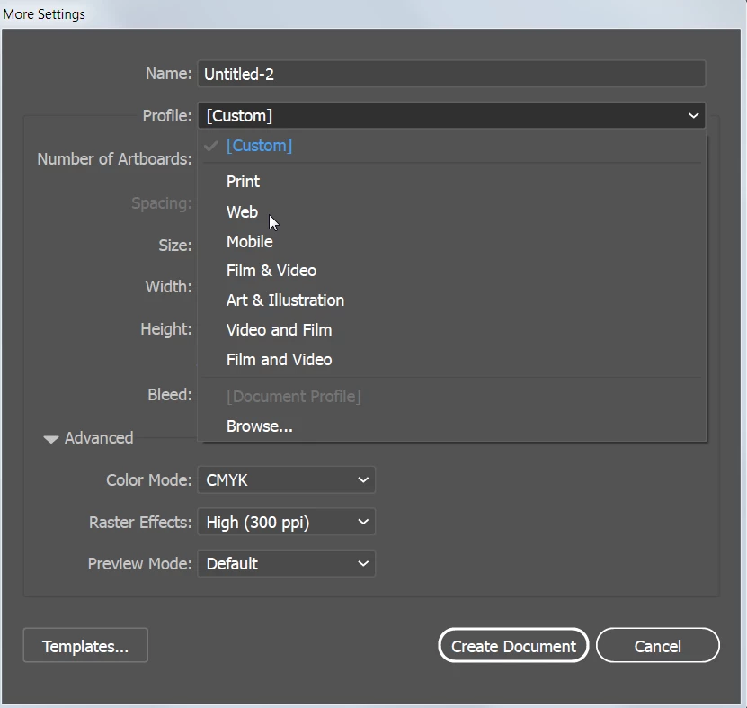

I designed a wedding invitation for a friend and it looks high resolution, the size is correct, everything says 300dpi but when I upload, fuzzy. It says that the Artboard Resolution was set to 375pts wide by 560pts wide. It needs to be 1417px wide by 2185px tall.
Here is the thing. I have Illustrator CS6 and Illustrator CC 2018. I couldn't see the above information but my friend, who I designed the invitation for, could. I could just see that it looked fuzzy when uploaded.
Where do I change this? How do I change this? Help!

    Since you are using the term "pixels", I think that when the file was first created it was probably set to the Web or Mobile profile.
    Make sure to choose Print when setting up the document. If you do, then all the default settings will be correct for what most print vendors would want: CMYK color, 300 ppi, etc.

    Michaela,
    Just to throw another spanner into the cogwheel, there is also the Effect>Document Raster Effects Setting.
    Apart from that, the figures are mismatched in terms of proportions.
    I am printing it through vista print but it is a paper wedding invitation.
    Their specs say you have to have 300DPI (which I do) actually, I made it 600 and it is still fuzzy.
    Which actual size is it supposed to be on the paper when printed in inches, mm, or points/pixels?
    You should be able to just create the Artboard at that size, then Export to the desired raster format at 300PPI resolution.

    I found where to change the Artboard size, the auto size was too small. However, it still uploads fuzzy. I went to document raster settings and set PPI to 600 to try to fix it, but it doesn't help.

    WHen those services tell you to have your artwork at 300 ppi and at specific pixel dimensions, then these services themselves actually don't fully understand what they're doing.
    This is the relevant information. Make it this size in pixels. Resolution actually doesn't matter then and will probably just be discarded anyway upon uploading.

    It is not for web content. I am printing it through vista print but it is a paper wedding invitation.
    What do you send to Vistaprint? An Image?
    They accept Illustrator and PDF files in vector format.
    Don't worry about the ppi unless you place images or use pixel effects (like a drop shadow).
    Send them a pdf and make sure that your artboard is 1417px wide by 2185px tall. As you mentioned in your first post.
