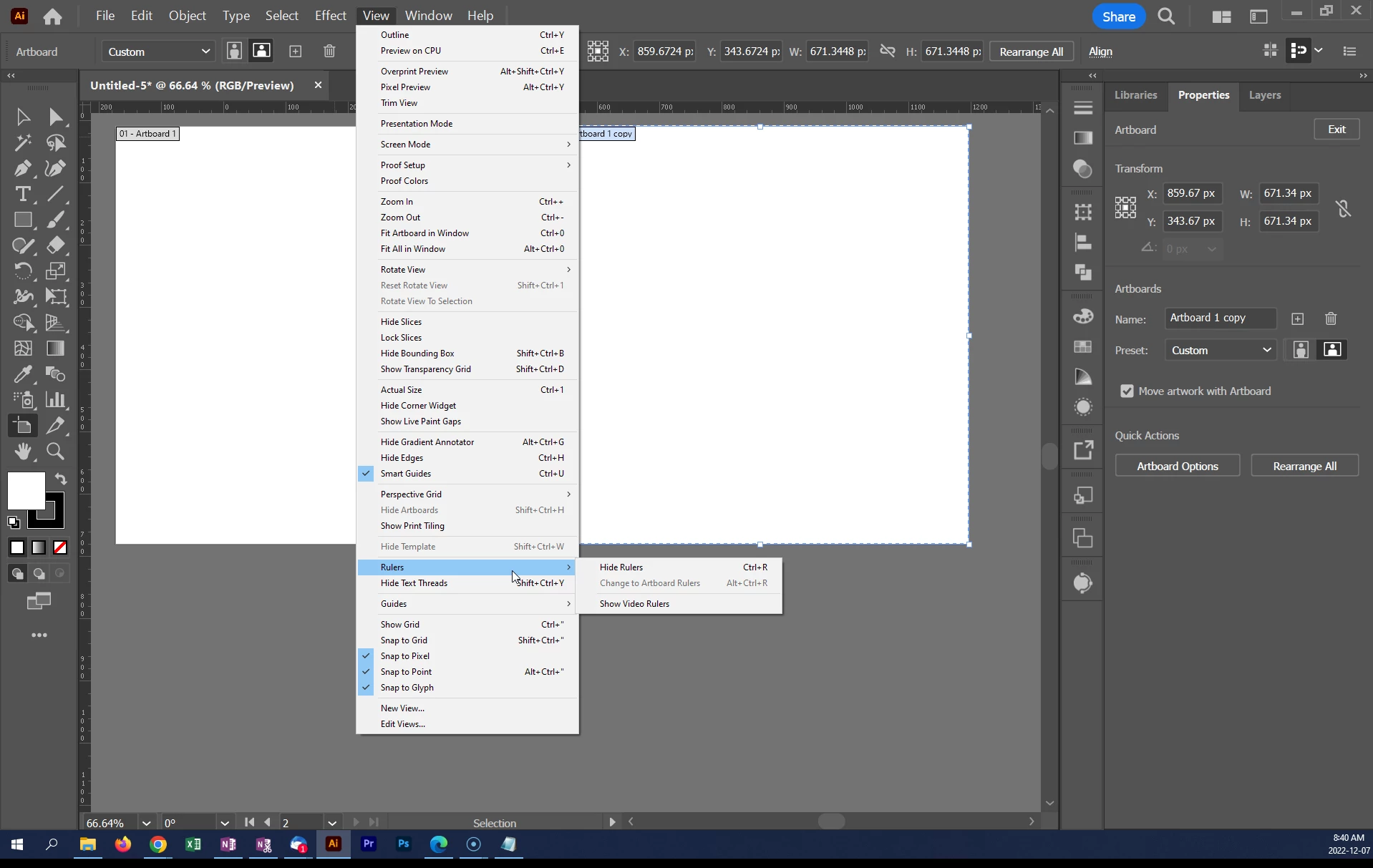

so it may be my memory is faulty but I remember being able to set it so each artboard in a document had a distinct ruler which in my mind would be artboard vs global rulers.  From reading the documentation artboard rulers are supposed to be the default and the option is greyed out in my view menu so I am assuming that artboard rulers are enabled but....  I just see the global ruler.  If I move the point of origin with one artboard active the point of origin is still shifted when I switch back to the other artboard.
What I want to do is be able to set it so each separate artboard has a ruler with its own independent point of origin.  I often make sets of graphics all in one ie 1080px x 1080px for Instagram and 800px X 600px for the blog post image and sometimes a google my business post image size too.
Is mine not working or it how I think this is supposed to work wrong?

The artboard rulers option is not greyed out in the menu. Instead the menu changes to "Global rulers". When Global rulers are active, it changes to "Artboard rulers". Can you please show a screenshot of what you are referring to?

Hi Monika:
please see the screen shot. I realize that artboard rulers / global rulers are a toggle from one to another but... I don't see an option to switch to global rulers and artboard rulers is greyed out. Any thoughts on what might be causing this?  When you use artboard rulers do you actually see rulers change to be along the artboard?

How many artboards are there?
