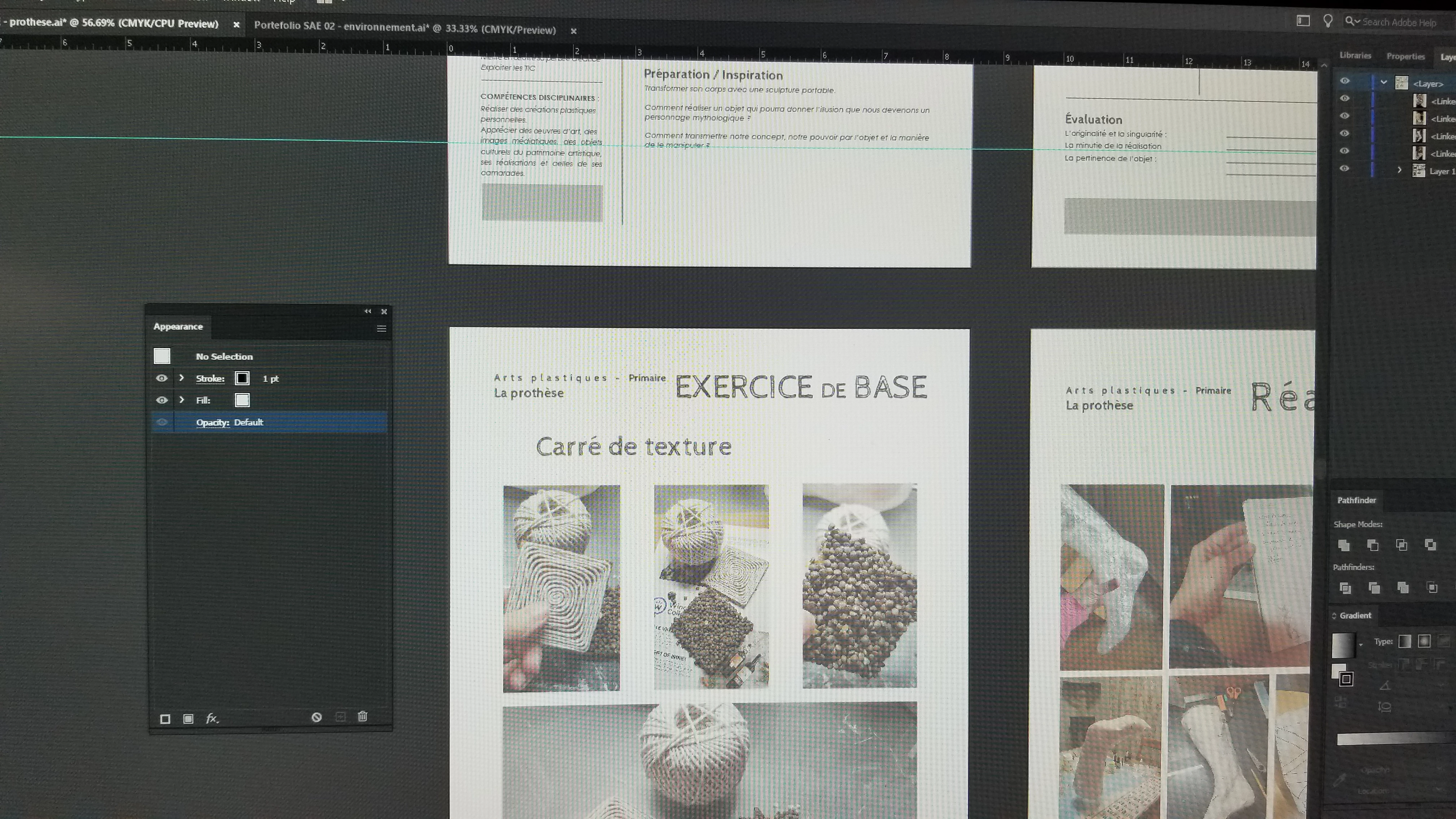

I dont know what happened but all the objects in my artboards turned out grey. If you check the image, my type is nomrally black and the rectangles up in the page are black 100% too.

Can you show the layers panel with the layer selected?
Check the Appearance panel and see if there is an effect aplied to the layer (if so, remove it)

hi!! THANKS!!
You helped finding! the problem was because all my layers went in another upper layer...Thanks, its back!!
