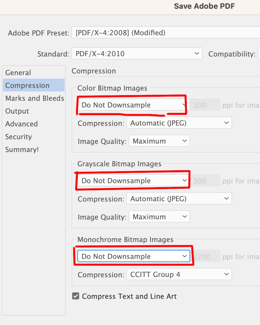

Afternoon folks - minor issue. I am working on the attached file, but when I export this business cards to PDF the linked image icons compress down and leave these horrible line artifacts along the sides. Wondering what causes this and how to fix this? Many thanks.

    This has nothing to do with embedding or linking.
    This is an artifact caused by Bicubic Downsampling in your PDF export settings (long story). Your design is pretty simple and your icons will compress nicely anyway so I suggest you turn OFF downsampling in your PDF export altogether. If you had more a more image heavy design, and needed downsampling to make it manageable, you can minimize/eliminate this effect by choosing Average Downsampling instead of Bicubic, but, like I said, you should be more than fine by turning it off.

    The problem probably has something to do with image compression and resolution settings in how the PDF is saved. If you choose lossless LZW compression or no compression at all that would eliminate lossy compression artifacts. Saving the PDF with the images preserved at their original resolution rather than being down-rezzed would make the icons sharper.
