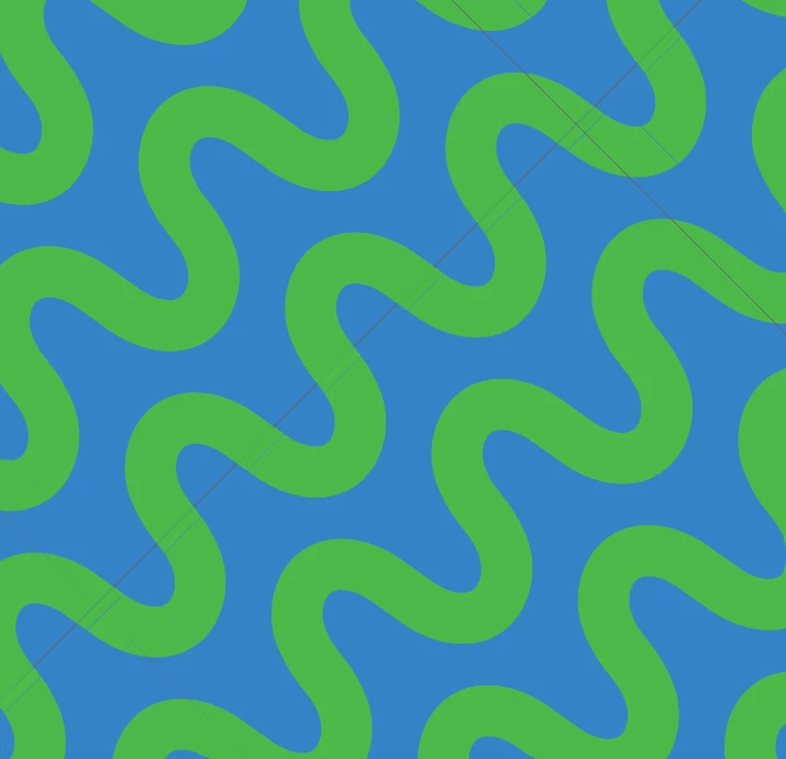

I am trying to create the attached into a seamless print however, I am coming across issues making it seamless given than there is a slight angle change and I was hoping someone would be able to assist without having to completely change my pattern. It started off as layer one but I wanted to scale it down to 60% and rotate it 315 degrees and now it is no longer seamless :(. Thank you in advance for your help 🙂

Your pattern is seamless, I printed a test page and looks good.
If you zoom in and see a thin black line, that does not print is just a defect in the redraw.

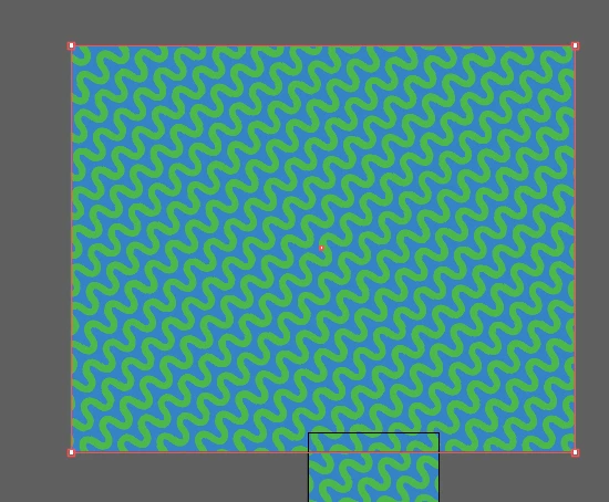

that is seamless but pretty much i need to give someone the original swatch which has a complete pattern "cycle" in it to print. But because of the slight angle change it would have to be such a big rectangle. Let me know if i dont make sense
August 25, 2021
to be more specific, side L on my AI file is not seamless with R side, and top is not seamless with bottom, and I need them to be.
