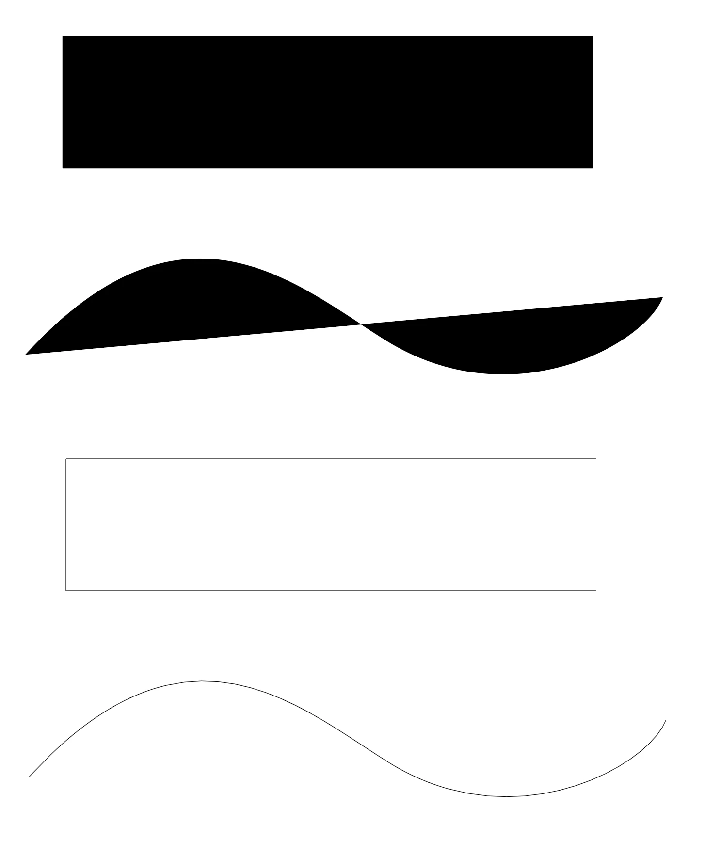

When creating a box in Illustrator, once I make three sides of the box, the program auto connects open points to make a fill, even though I haven't finished adding the fourth side to create a closed vector shape. I'd like turn that feature off, but I am not seeing the option in the Prefs. Possibly, there is a check box somewhere in the Pen Tool?
Thanks, MJ

if you have set any Fill On, Illustrator tries to fill the form when it has at least 3 points, It does not matter what kind of segments the shape has: Fill visually connects the endpoint by straight line. The only way to avoid this is to make sure that Fill is set as None before starting drawing like David suggests, Or, if you've forgot this, set Fill as None right during drawing.

I usually just set my fill to None while I'm drawing and fill afterwards. You can use a Graphic Style to speed up the changed.

I did a couple of screen grabs to illustrate my question. I have been in the sign business a long time and use plotters and routers to follow the vector edges to cut out shapes. Some Illustrator designers leave off the necessary last part of a shape that would create a closed shape. The images look fine on screen, but won't cut correctly. I would need to find the open shapes, then select it and complete the necessary sides using the pen tool.
That's one issue.
If I make a simple wavy line, as in the example, then want to apply a textured, tapered brush over it, the autocomplete feature gets in the way.
It is also possible for me to go to the layer attributes and turn off Preview, but I'd prefer a preference check box to turn off the autocomplete fill feature.
MJ
