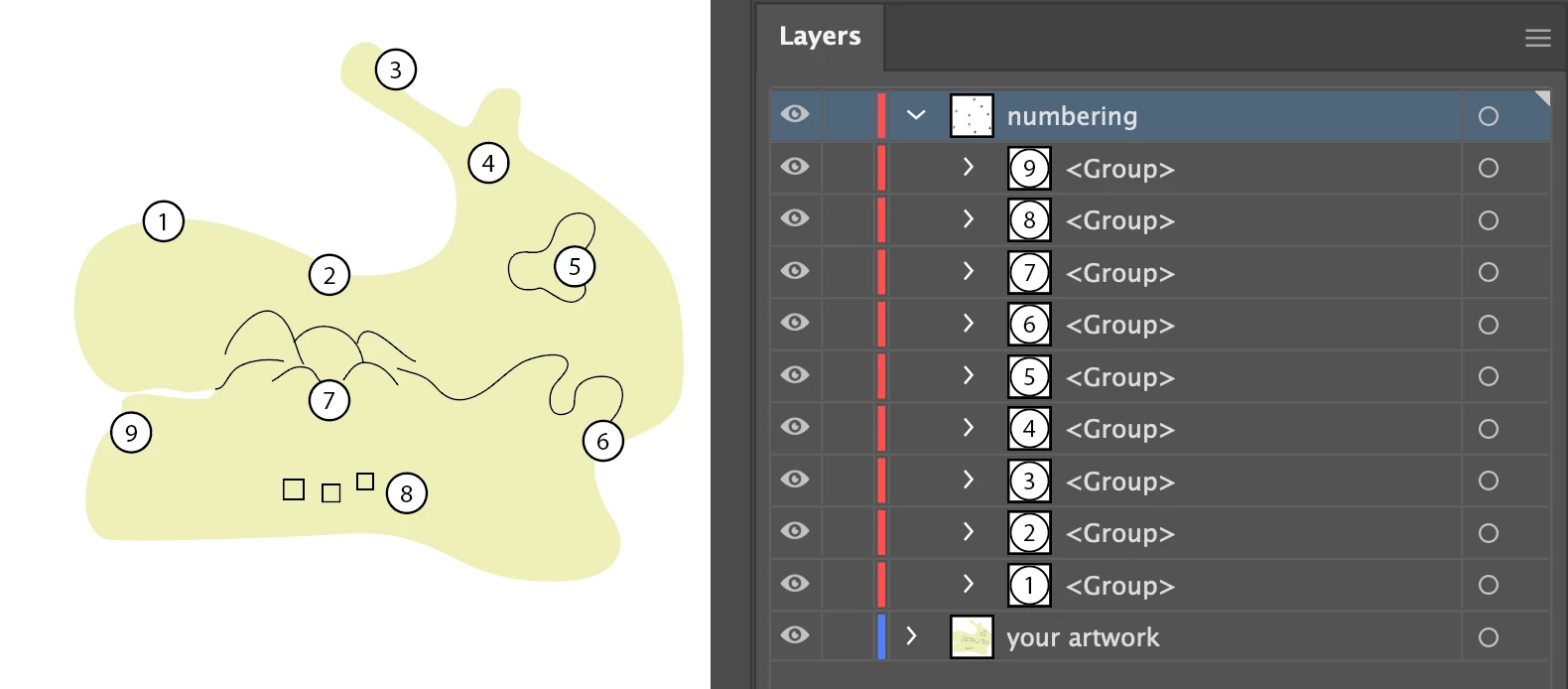

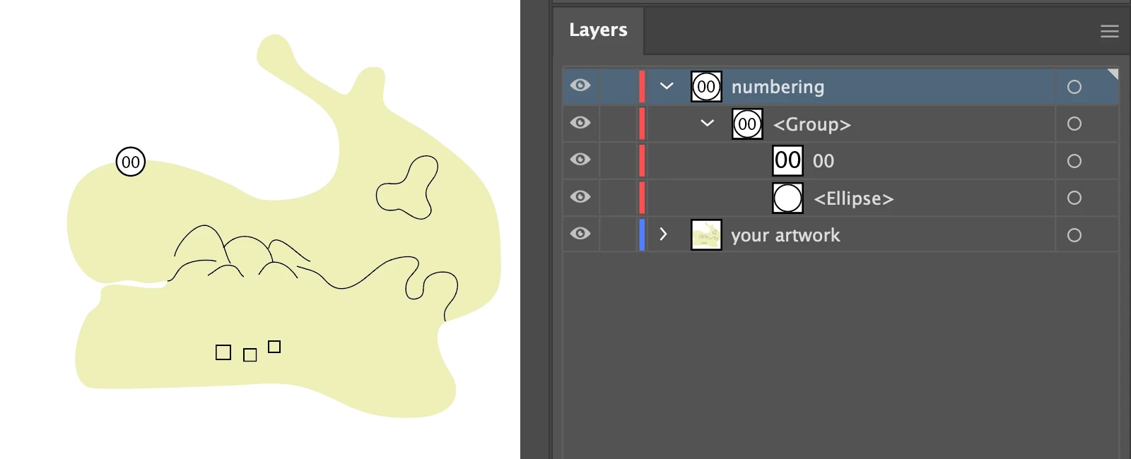

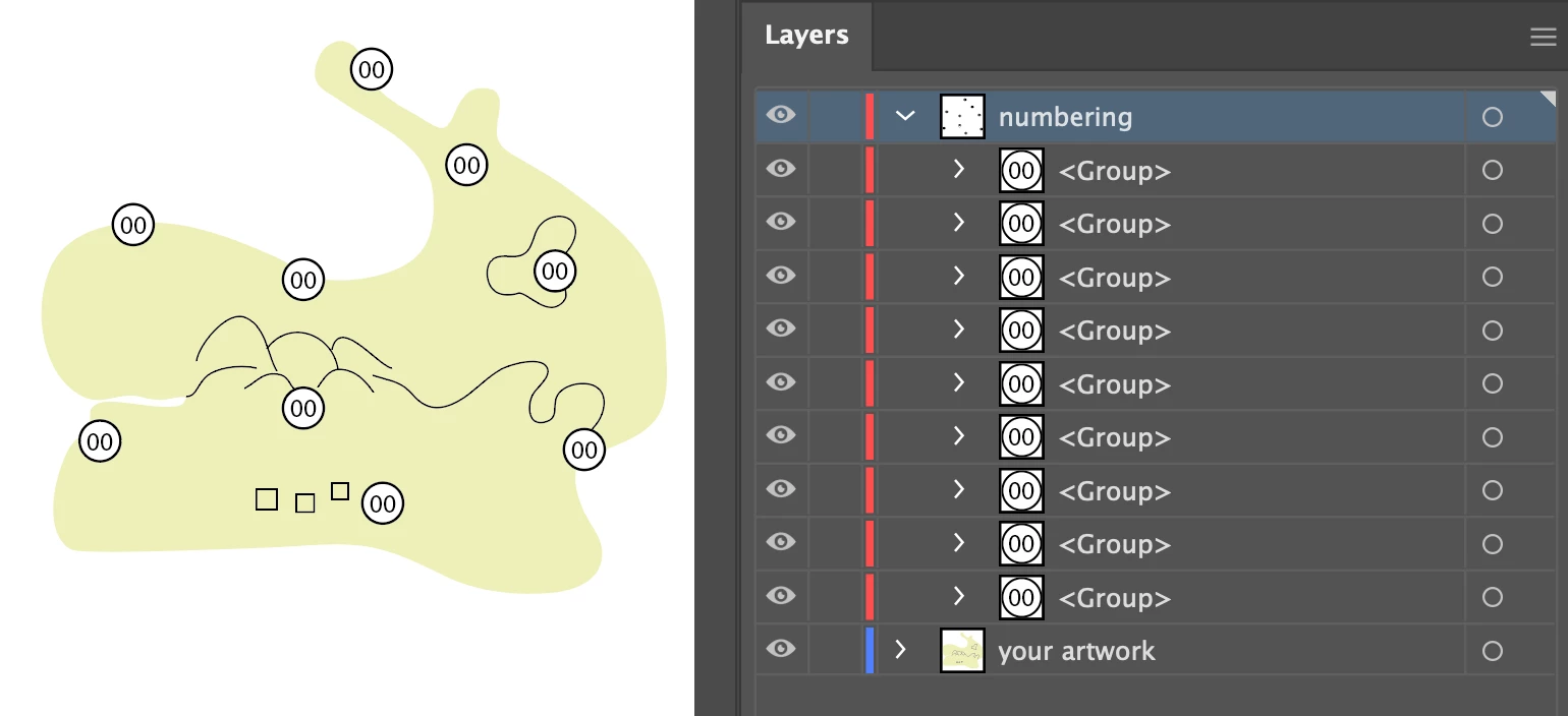

Hi @polotrobo, as others have said, the scripting API doesn't give access to duplicate page item event so it can't be automatic unless you create a plug-in, which is much more involved.
However, my solution to this type of problem is to
(a) put all the numbering markers on a layer of their own, eg mine is called "numbering",
(b) duplicate them in order, starting at 1
(c) run this script:
 * Sets the contents of first text frame
 * of every group item on specified layer
 * to the value of a counter.
(function () {
    var doc = app.activeDocument,
        numberingLayer = doc.layers.getByName('numbering'),
        items = numberingLayer.groupItems;
    for (var i = items.length - 1, n = 1; i >= 0; i--, n++)
        items[i].textFrames[0].contents = n;
(d) to adjust the order afterwards, just move the markers up or down in the layer panel and run the script again.
That's how I would do it.
