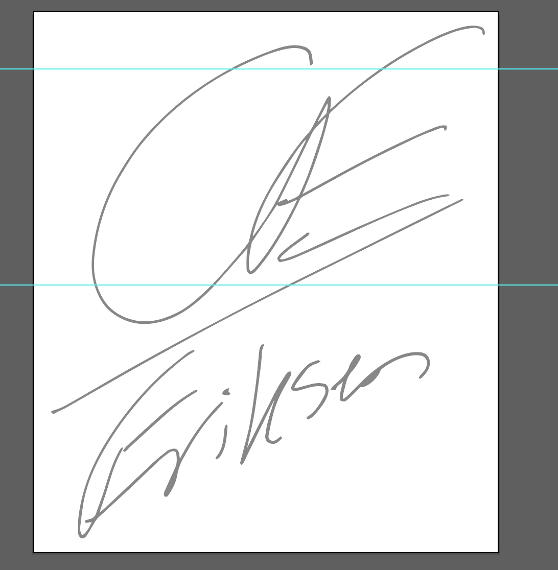

I need to be able to make my traced autograph thicker, as it needs to be printed as a sticky.
But, i need to do this withouht using stroke, as the company's printer will regard the stroke as an extra cutline.
It needs to only have 1 contour cut with 1 line.
I hope someone can help me achieve this asap.
Ive posted a screenshot of the autograph

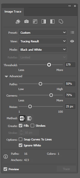

Otherwise, have you tried pushing the threshold a bit in the autotrace window? Sometimes it tends to thichen the lines (I found)
It may not be super precise though...
