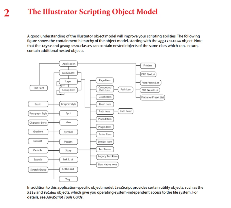

I'm trying to use Javascript to automate the task of creating a QR code using the extension of illustrator, but it doesn't work very well.
The problem is that I can't find the object that manipulates the extension in The Illustrator Scripting Object Model.
Is it impossible to automate work with Extensions using Javascript?
If anyone knows, please answer.
Version: Adobe Illustrator CC (25.3.1)
Extension: QR Code Maker Pro
https://exchange.adobe.com/creativecloud.details.13171.qr-code-maker-pro.html
Document: https://www.adobe.com/content/dam/acom/en/devnet/illustrator/pdf/AI_ScriptGd_2017.pdf

You can try rolling your own QR-generator by using a javascript that is found online that also can be ported to ES3-based ExtendScript. Or you could take advantage of non-ported, modern JavaScript if you were to make your own CEP extension - but this example here is possible with just regular scripting.
https://www.linkedin.com/pulse/illustrator-variable-data-super-advanced-techniques-vasily-hall/

var thisVarRx = new RegExp("<<" + thisVar + ">>", "g");
var x = encodeURIComponent(varText.contents);
str = str.replace(thisVarRx, encodeURIComponent(varText.contents));
var close = (doc.activeDataSet == doc.dataSets[doc.dataSets.length - 1]) ? true : false;
var qr = new QRGen();
var newQRCode = qr.makeQRInIllustrator(str, false);
sizeAndFitTo(qrLanding, newQRCode);
newQRCode.note = str;
} catch(e) {
return;
QRCodeFromLayerData();
This code is designed to work inside of a batch action process and it also uses extra string manipulation to create a QR input from various strings. You can try to remove that particular set of blocks and make it do just a simple string, it should work.
September 11, 2021
As @Mylenium suggested this is entirely upto the developer to provide the API hooks that you can use for your automation. However, you could proceed a bit and read the source code of the etension if it is in jsx format, that will show you the methods used by the extension to do stuff and you can then playaround with calling those functions.
-Manan
-Manan
Mylenium
September 7, 2021
That would be entirely up to the developer to define hooks, functions and variables that show up in ESTK and such. Given the bad ratings this extension has I'm not optimistic the dev ever bothered with any of that...
Mylenium
