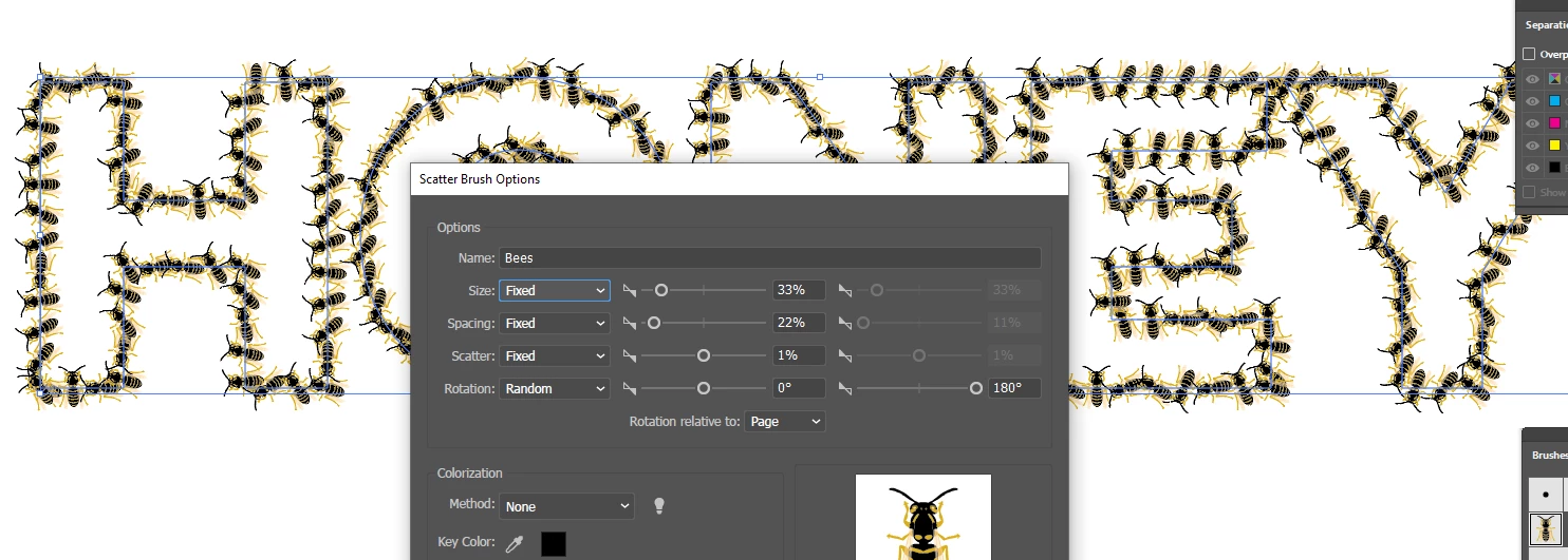

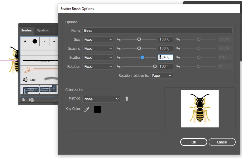

Make a scatter brush
Apply the brush to the outlines of your type, with the fil set to white

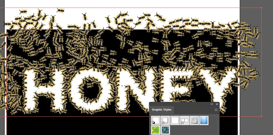

Then draw a rectangle in the background layer, and use the symbol sprayer. Then obviously remove the black fill, I only used that to help me temporarily confirm my layer & compound path setup
