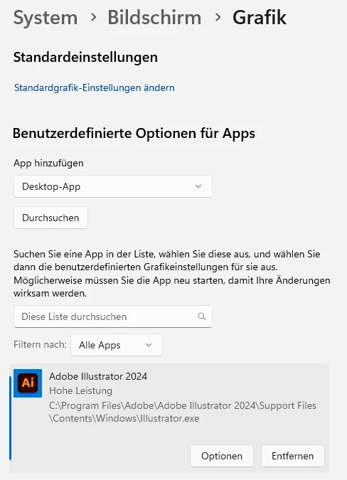

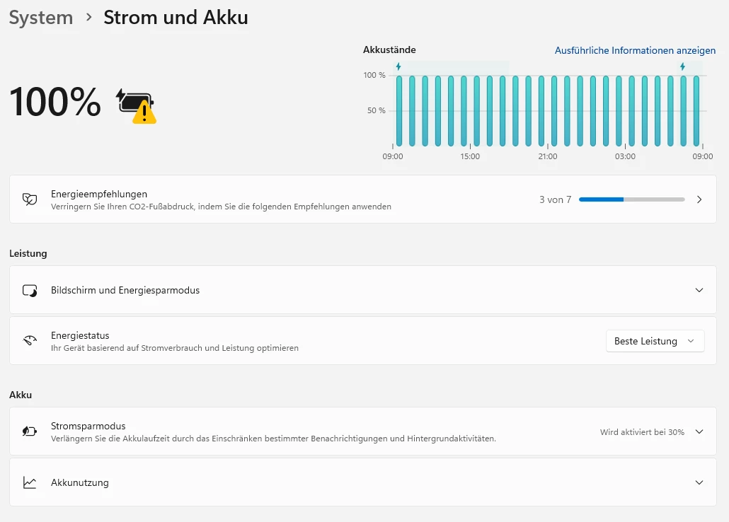

  • Leistung auf "Beste Leistung" gesetzt (siehe Screenshot)
  • Grafikeinstellung für Illustrator angepasst (siehe Screenshot)
  • In der NVIDIA Systemsteuerung die GPU für Illustrator zugewiesen (siehe Screenshot)

I had a very long conversation with Gemini, but finaly found a solution:
Fixed: Adobe Illustrator Zoom Lag/Stutter on Windows (Multi-Monitor & DPI Scaling Issue)
If you are experiencing a 1-2 second lag every time you zoom in or out in Adobe Illustrator, even though your hardware is powerful and other apps like Photoshop or Premiere run perfectly, the issue is likely a DPI scaling conflict between Windows and Illustrator's GPU performance.
The Problem
When using multiple monitors (e.g., a laptop and an external screen) with different Windows scaling factors (e.g., 175% on the laptop and 150% on the monitor), Illustrator’s GPU renderer struggles to recalculate the vector paths and the UI grid simultaneously. This causes the "thinking pause" during every zoom tick.
The Solution (Step-by-Step)
  1. Close Adobe Illustrator.
  2. Locate the Illustrator.exe file on your computer.
    • Default path: C:\Program Files\Adobe\Adobe Illustrator 2026\Support Files\Contents\Windows
  3. Right-click on Illustrator.exe and select Properties.
  4. Go to the Compatibility tab.
  5. Click on Change high DPI settings.
  6. At the bottom, check the box: "Override high DPI scaling behavior."
  7. In the dropdown menu "Scaling performed by:", select Application.
    • Note: This forces Illustrator to handle the scaling itself instead of letting Windows "stretch" the GPU output.
  8. Click OK and restart Illustrator.

Hallo Daniel,
ich konnte das Problem zumindest eingrenzen und so in den Griff bekommen, dass ich nur noch mit dem Original-Netzteil vom Notebook arbeite. Anscheinend gibt die Docking-Station nicht genug Power weiter...
