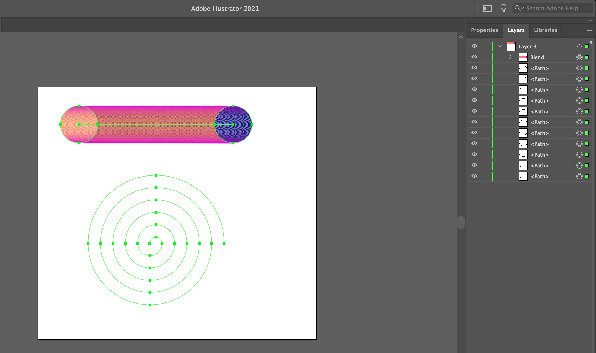

I tried working with a blend and a path but the replace spine option is not working. It is not a compund path nor grouped. Plese help. Attaching screenshots.

If you are trying to replace the straight path with the spiral, then you must make the spiral a continuous path instead of multiple paths. Try after selecting all the paths of the spiral and use Object>Path>Join.

You can only replace with a single path. You have several here. Use the spiral tool perhaps to create your continuous path.

I wanted to make a linear spiral, which wasn't possible with the spiral tool. But I found the workaround to the issue.

This worked! Thanks, Larry
