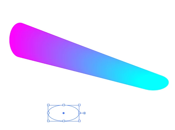

Blend tool- object snaps back to original position.

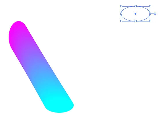

In version v27.0 the blend tools is not working properly, as far as I can see. When I blend between two objects and want to reposition one of the objects, it will snap back to original position and leave a "ghost" object (invisible) in the position I moved the object to. I am experiencing this on the two different computers I have access to.
Has anyon else encountered this in the lates version (v27.0)?

Kurt Gold
Nov 1, 2022 12:00 PM UTC
Replicable here as well.
It should be mentioned that it does not happen if you are moving the objects with the keyboard arrow keys. Also, the "ghost" object can be repaired by slightly moving it back and forth with the arrow keys.
And curiously enough it does not happen at all if you are are clicking on the centre point of the object and then moving it with the mouse.
Ton Frederiks
Nov 1, 2022 11:13 AM UTC
Yes, I can replicate that and the same file behaves as expected in AI 2022.
