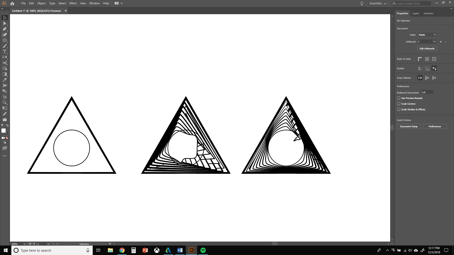

Hi, What ive done is created a triangle shape and applied no fill and a black stroke. Inside the triangle is a small circle with no fill and a black stroke. When I blend the two, the stroke doesn't blend the way I wish it to. I want it to create a number of "transition" shaped strokes, but instead it creates a sort of spinning effect. I hope it makes sense what I am looking for.. Id post a picture, but im not sure how to achieve the effect. Attached I will show the problematic blend. One is blending from Triangle to Circle. And the other is Circle to Triangle.

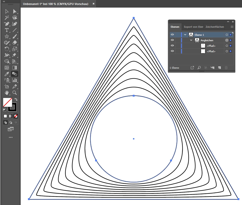

You need (for a "good" blend) the same corresponding anchor points for each element:
Have fun

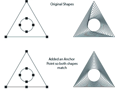

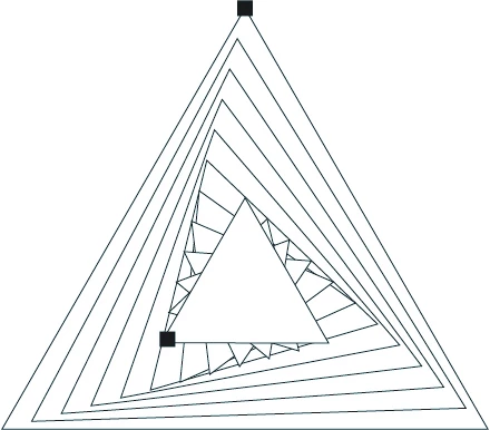

Two Problems may be happening
1. Each shape carries a different number of anchor points
2. Based on the way you draw the shape you may have the first anchor point on the other side of the shape so it will have to twist to blend.
You may only need number 1 but if it does not fix it try choosing the first point (first vertex)
Blends are using Anchor Points
Blend is really an Anchor Point control. It is shaping using anchor point to anchor point. So your circle has 4 point and your triangle has 3 points. This means that 2 points in the circle need to merge.
1. FIX: Adding the same number of points
In the one picture below you can see by adding a 4th point to the triangle it will change the shape.
This should fix it unless your first vertex is in another place. Below is an example of not choosing the first vertex but drawing one triangle starting on the left and one triangle starting on the right. (I am choosing the path in the image with my blend tool in the picture below and not the point but the way I created the original shapes is changing the blend)

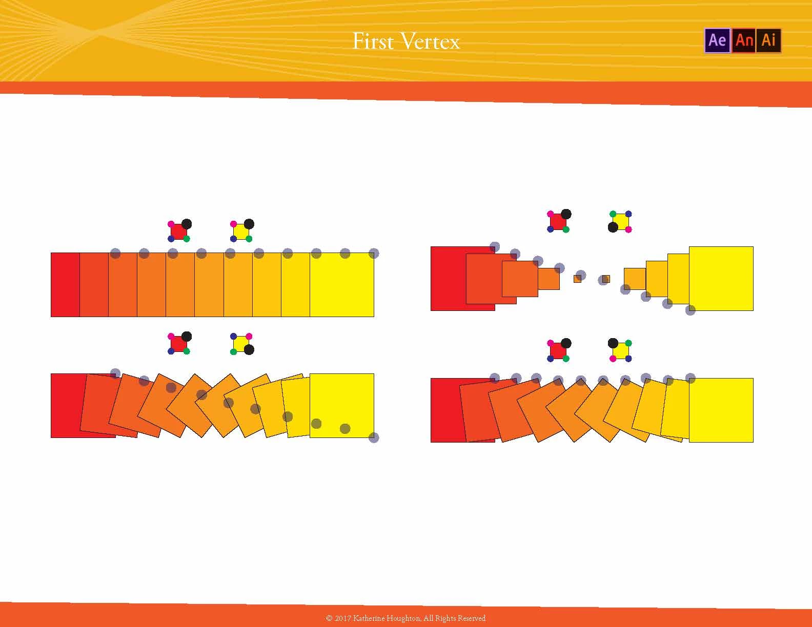

2. FIX: Choosing the First Point (vertex)
I also added a picture showing if you control the first point for each you can change the shape. When the tool is a white box at the end it is choosing the first point for you if you move the tool over a point it turns black. This will be selecting the first point which will again change how it blends. (When you draw something, wherever you click down first is the first anchor point, so sometimes we need to help the shape choose the first anchor point. This means that your shape will be different depending where you started each path)
Let me know if this helps.

Use the required minimum of anchor points. In this case 3 anchor points will give you the best result. For getting a circle with 3 points read the Jacob Bugge​ post again.

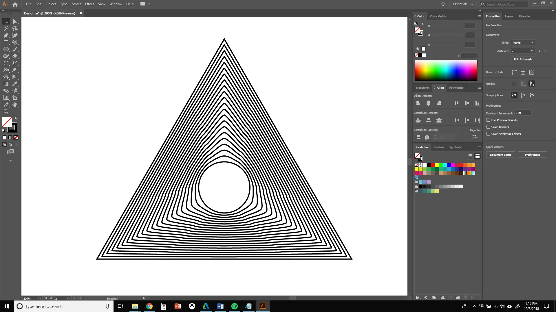

December 5, 2018
Worked pretty nicely! Both ways equally. Here is the result:
(My only complaint is there is a small amount of rigidness in the transition. Obviously from the added anchors. You figure there is any way to make the transition a little less lumpy? Thanks so much, if there isn't any way I will roll with this, thank you so much for your input! Couldnt find an answer anywhere on the internet. I was surprised that the question didn't come up more.
