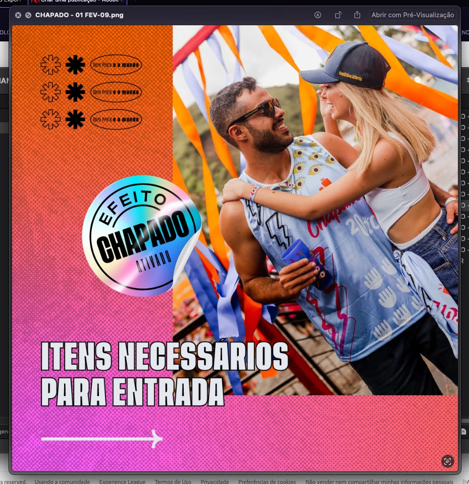

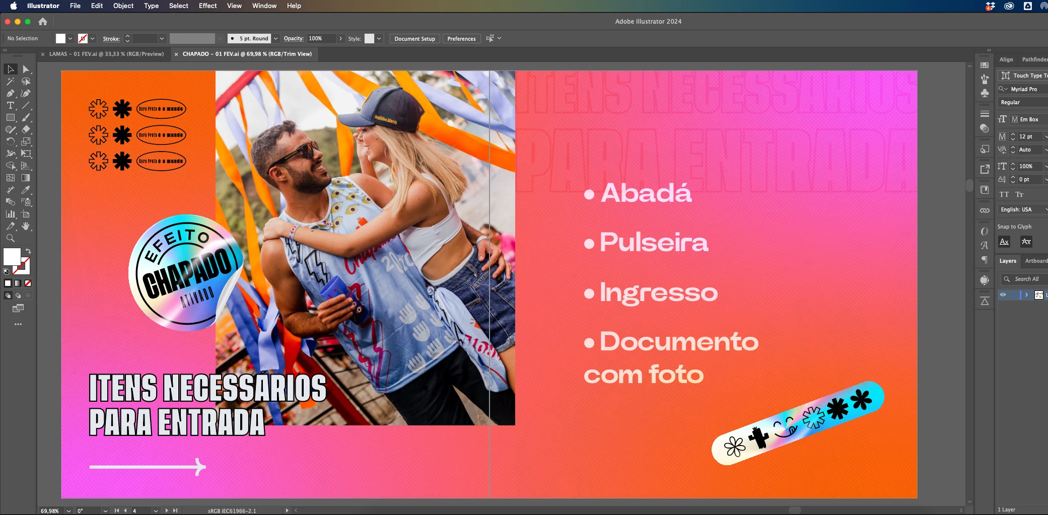

When i'm editing my file, the texture looks ok, but when I export, the texture is completely different than what I see inside Illustrator.
Is there a way to fix this? What am I doing wrong?
This is very annoying because I need to double check the exported file to make sure the texture comports the way I want to.
I'll attach some print screens.

Which version are you using? There were some problems with blending modes that were solved in 28.2
Ton Frederiks
Ton FrederiksCommunity ExpertCorrect answer
February 9, 2024
February 9, 2024
I'm using 28.1.
I will update soon!!
