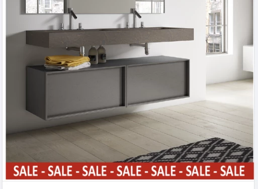

Hi can someone help please 😞 I am trying to upload the first image to web, however when it goes onto web the coloured text comes out blurry and really rubbish quality. I have attached an example so you can see what i mean of how it comes out when uploaded to web.

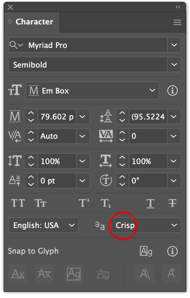

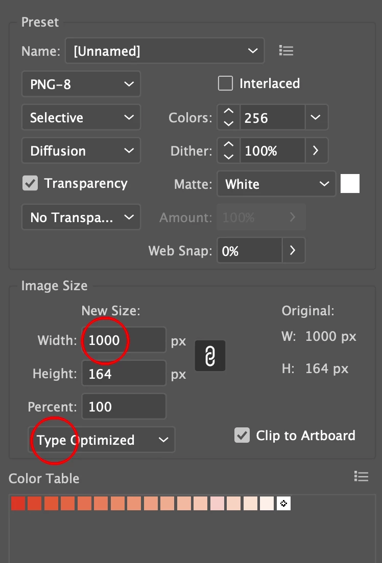

Your question does not provide any of the settings, or what your destination pixel size is. Most likley you need more pixels, or having more pixles than needed if quality is an issue.
Here are settings you especially need to pay attention to
The top row of type is done with none, the bottom with crisp

Hi Mike!
Yeah im not familiar at all trying to learn myself through tutorials ect for social media for work. However from your examples you've shown it looks like that could do the trick so thankyou very much 🙂

You export is to JPG or PNG, right? This is a raster based format, so blurriness has to be expected. On top of that, if you upload to Social Media: they apply their own compression, which makes the whole thing worse.

You cannot change the compression algorithms of Facebook et al.
Only thing you can do is adapt your design to it. Use larger Text, avoid high contrast, so the compression isn't as visible.
