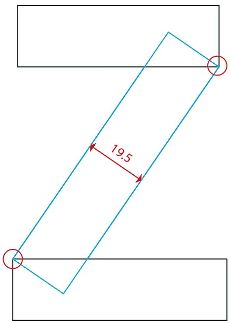

Jacob BuggeCorrect answer
Jul 26, 2024 10:27 AM UTC
Dworkin,
If you wish to keep the distance/positions and sizes of the two horizontal rectangles, the top one being shorter and centred over the the bottom one, you can (Smart Guides being your friends):
1) Draw a line from le point haut gauche du rectangle du bas to le point bas droit du rectangle haut; you can use the Line Segment Tool and use Smart Guides to snap it to these points;
This line is you first guide line from 1) in the following:
2) Read the length of the line in the Document Info panel and create a circle with W = H = 2 x the length of the line, then place the circle with its centre at le point bas gauche;
This circle ought to go through le point bas droit du rectangle haut; the crossing of this circle and the vertical rectangle is used in the following:
3) With the Direct Selection Tool ShiftClick le point haute droit of your vertical rectangle vertically down to the crossing;
4) With the Direct Selection Tool Click le point haute gauche and then use Object>Transform>Move which has the right value;
This ought to reduce the height of the vertical rectangle to the right value;
5) Draw a line from le point bas gauche of the vertical rectangle to le point haut droit of the vertical rectangle with the Line Segment Tool and use Smart Guides to snap it to these points;
This line is you second guide line from 5) in the following:
6) Select the reduced vertical rectangle and the second guide line from 5) and Group them;
7) Select the Group from 6) then switch to the Rotate Tool, then Click le point bas gauche and ClickDrag the second guide line to snap to the first guide line from 1);
Now your reduced rectangle ought to fit between the horizontal rectangles.
Edit: The first guide line from 1) is between the two red circles in your screenshot.

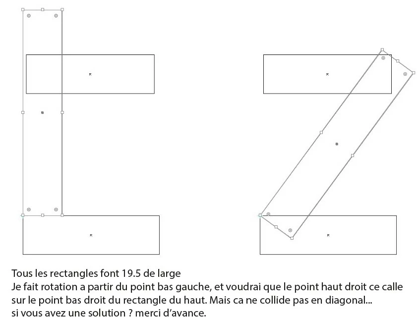

Jacob Bugge
Jul 26, 2024 9:41 AM UTC
Dworkin,
You specific task is impossible, beause the distance between le point bas gauche and le point haute droit of your vertical rectangle is greater then the distance between le point haut gauche du rectangle du bas and le point bas droit du rectangle haut.
There are different solutions depending on the necessary change(s) you prefer to make.
Votre tâche spécifique est impossible, car la distance entre le point bas gauche et le point haute droite de votre rectangle vertical est supérieure à la distance entre le point haut gauche du rectangle du bas et le point bas droit du rectangle haut.
Il existe différentes solutions selon le(s) changement(s) nécessaire(s) que vous préférez apporter.
DworkinZ
DworkinZAuthor
Jul 26, 2024 9:54 AM UTC
Voila le résultat souhaité, comment pivoté mon rectangle diagonale pour que les 2 points entouré match ?
