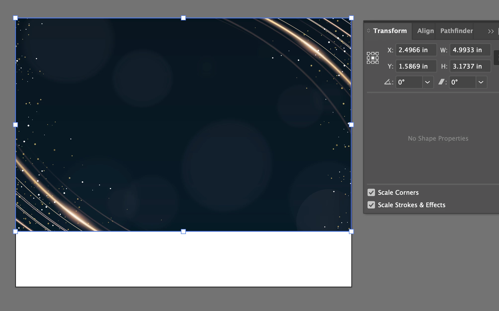

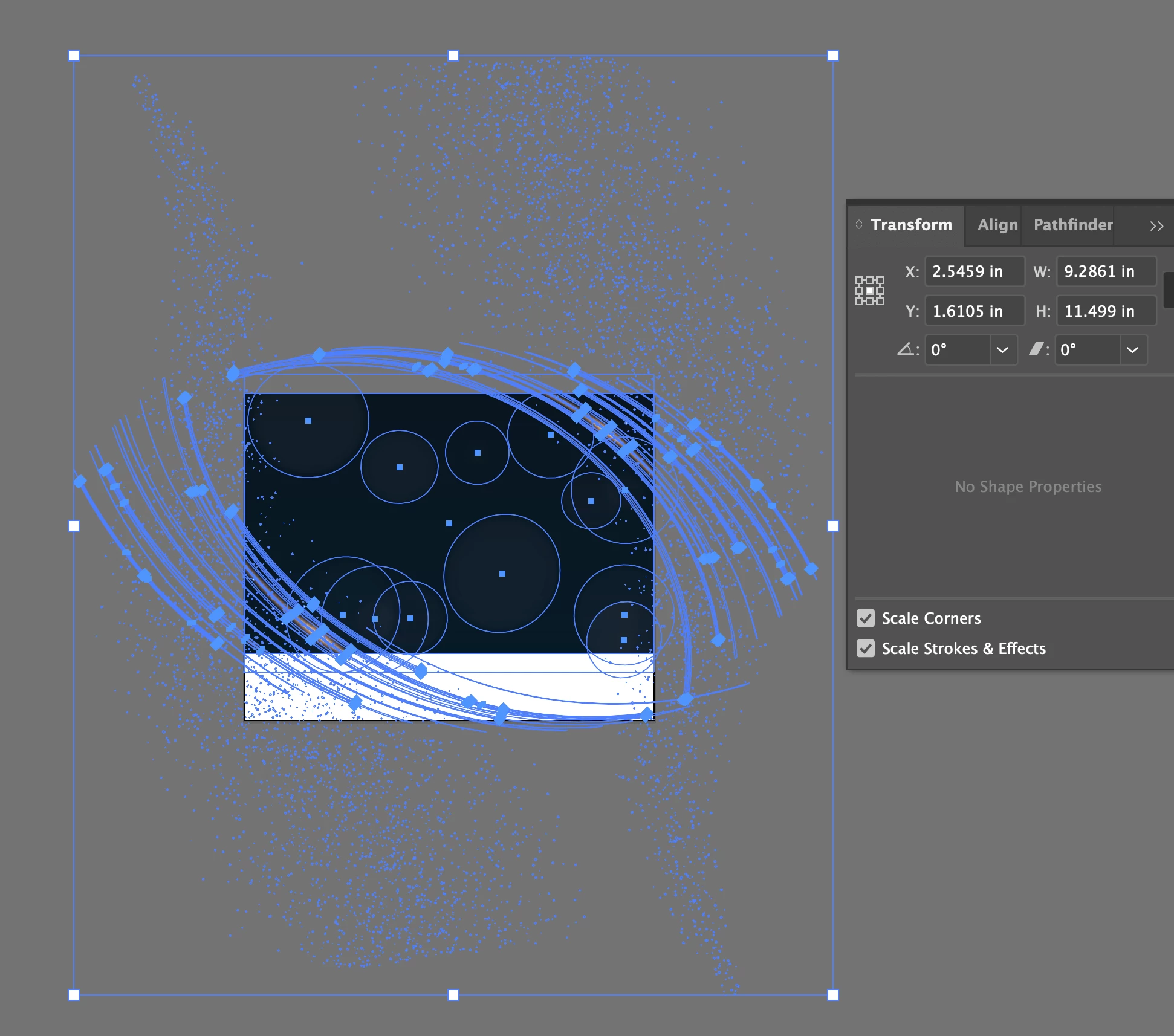

With one of the recent updates, I suddenly have an issue with clipping masks and their bounding boxes. When I select a clipping mask, the bounding box appears normal, treating the mask/frame as the extent of the artwork. but when I then scale try to scale/transform it, the bounding box suddenly extends past the frame of the clipping mask to encompass all the artwork inside the clipping mask. This is very frustrating and I haven't been able to find a solution or even a discussion on this issue. Has anyone else run into this problem?

November 21, 2023
No isolation mode. I have the clipped art shown in my screenshot, selected with selection tool (V). When I grab a corner of the bounding box to resize OR type any size in the transform palette, suddenly all paths within the clipping mask are highlighted and the bounding box extends to the bounds of those paths. As you can see in the transform palette, the extents of the measurements change with the bounding box.
