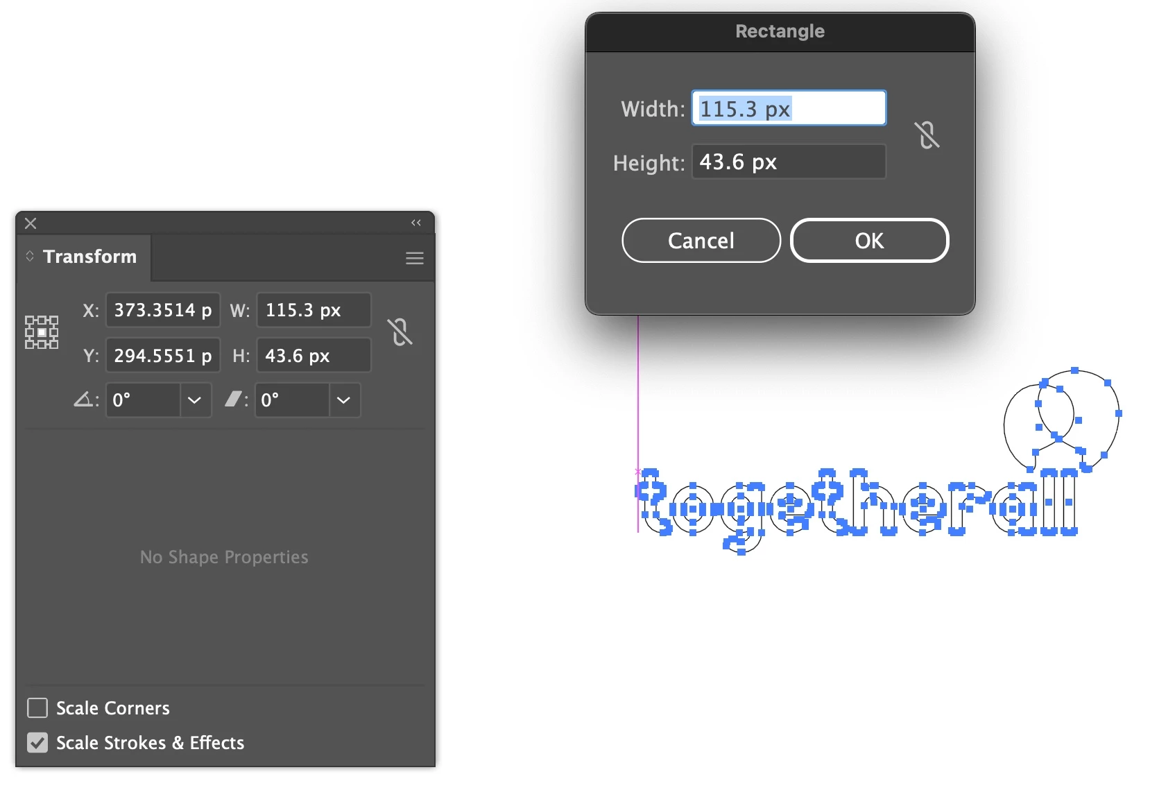

I know what you mean, but have a trick to fix this.
Use the transform tool to see size of your objects. Create a rectangle (option click to get sizes) to that size with stroke & fill of none, then align the group of objects against the rectangle you created.
  Then use the transform tool to move around.

Thank you for replying. I did try this several times, also after relaunching and restarting, but it did not resolve the problem. I am also looking for ways around this, but as yet have not found any.
