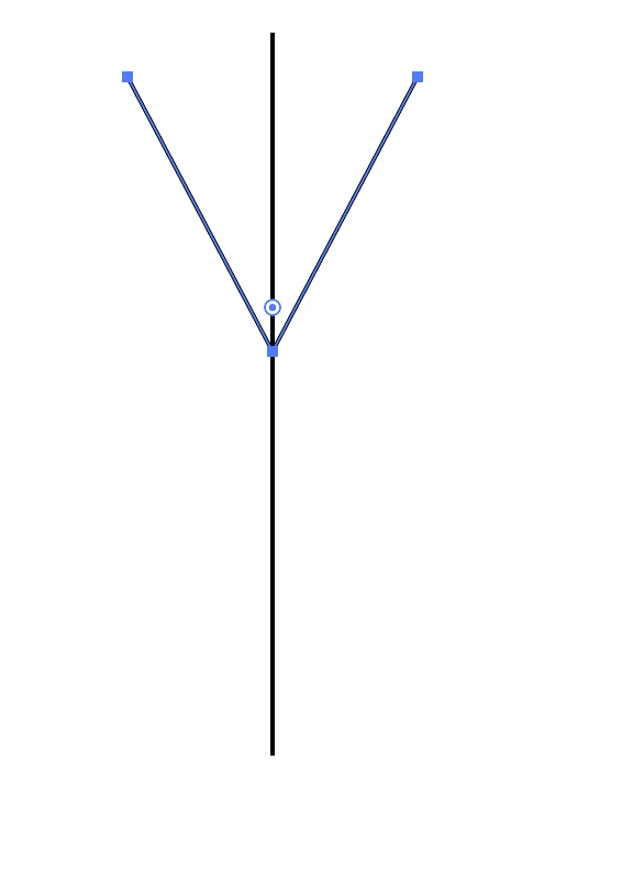

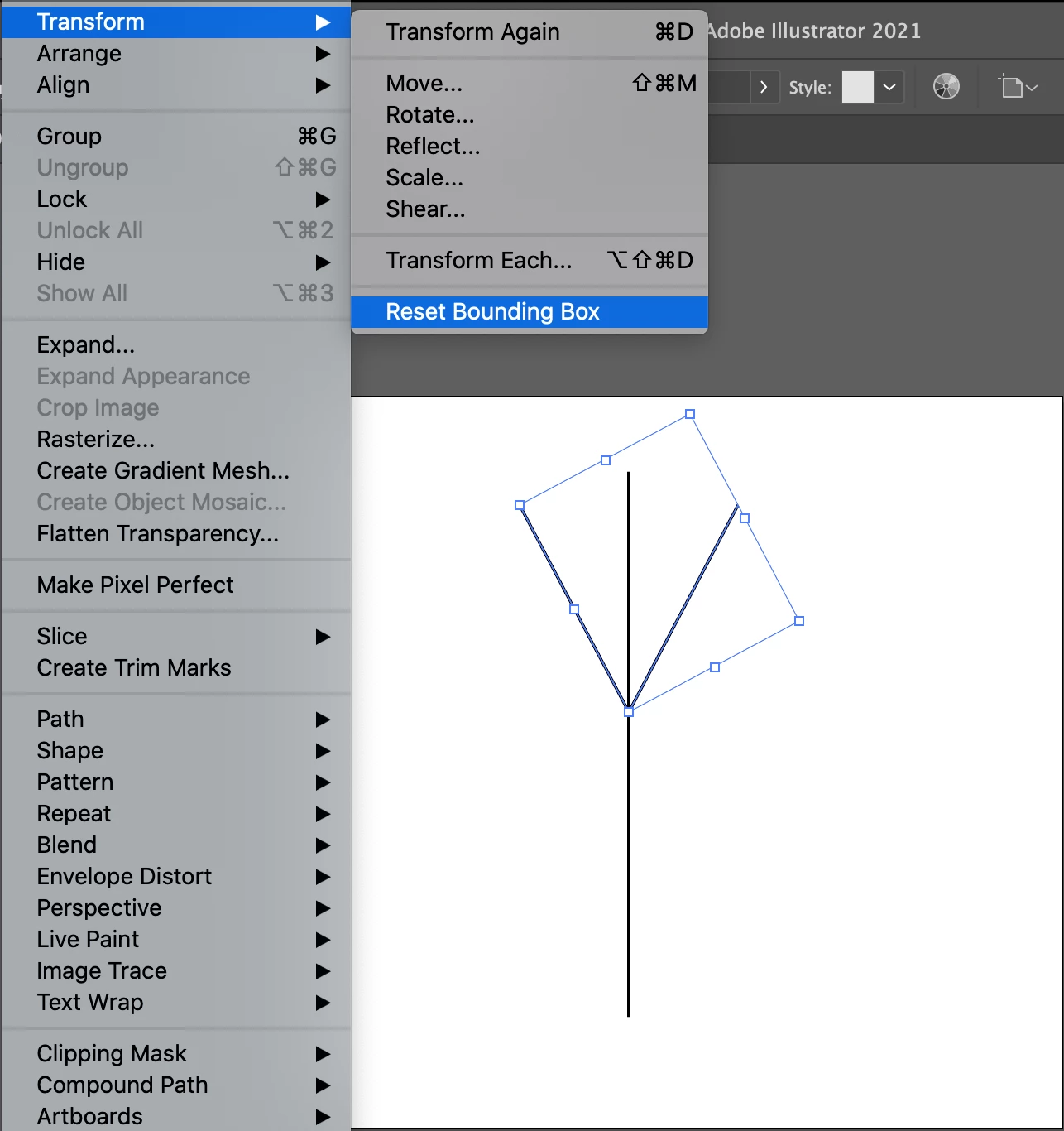

    hello, can some one help me with this the above image? I cant transform the scale. Tried with reset bounding box and expand shape but nothing happen. 😞
    Ton Frederiks
    April 26, 2021
    View > Show Bounding Box?

    April 19, 2021
    It will be there if you made changes and created and different angles.   For rectangle you need to expand . In this example it is a line.
    Will be helpuful to give us screenshots!!

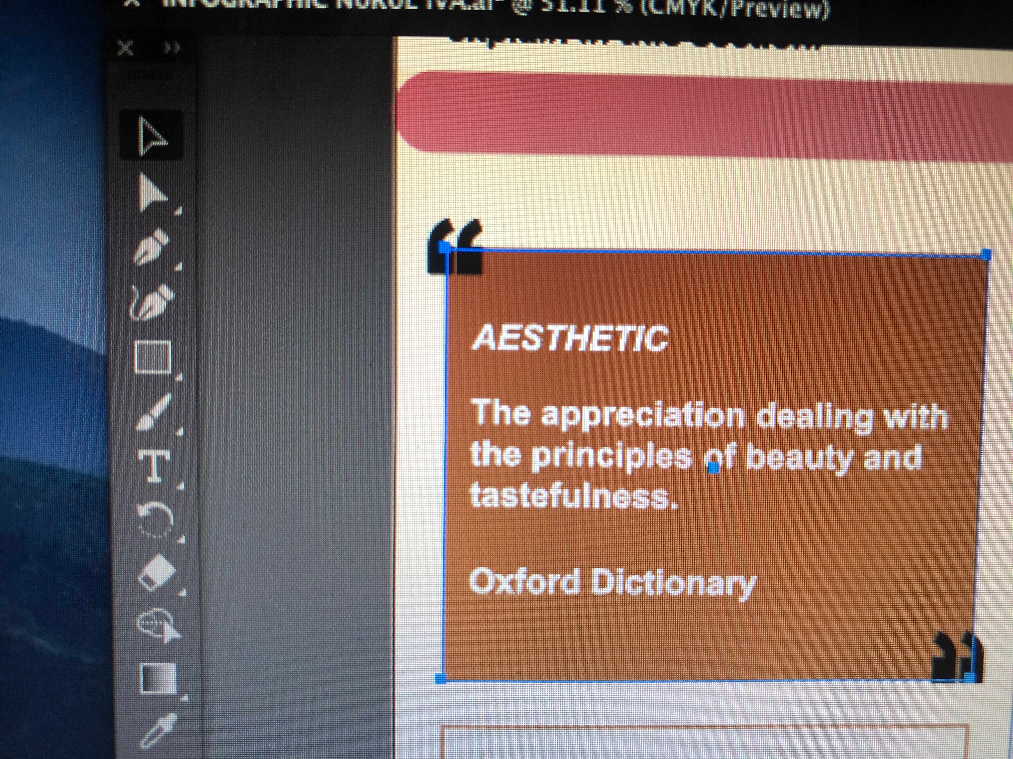

    Monika Gause
    October 24, 2019
    What kinds of objects?
    danac16722522
    October 24, 2019
    Polygons (6 sided), squares.  I can SEE the bounding boxes, and I can make them go away/return.  But when I go to Transform, the Reset Bounding Box option is grayed out.
