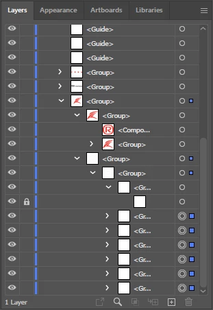

Eduard Buta
December 3, 2020
Thank you for your reply.
First thing's first, I've taken the entirety of the code above and dropped it in a notepad file which I then saved with a .jsx extension.
var doc = app.activeDocument;
var unlockLayers = function (layers) {
  var n = layers.length, layer;
  while (n--) {
  layer = layers;
  layer.locked = false;
  layer.layers.length && unlockLayers(layer.layers);
unlockLayers (doc.layers);
I wasn't aware that layers need to be in a certain way for this to work. I am looking for a solution that I can run and unlock all the layers within a specific document, no matter how they're stacked and nested. Let me know if that's where I was missing some info. See a test I've tried below:

pixxxelschubser
November 25, 2020
Welcome in your own new thread.
Try to add these two lines at the end of the script:
app.executeMenuCommand("unlockAll");
app.redraw();
If that works for you
have fun
Eduard Buta
December 2, 2020
Apologies for the late reply. I've been away until this time.
It still doesn't seem to work for me. I get an Error 1302: No such element on Line 8: layer.layers.length && unlockLayers(layer.layers);
Do you have any idea what might cause this? Thank you in advance!
pixxxelschubser
November 25, 2020
Ok.
At first: I didn't wrote this script. It was written by @Loic.Aigon
Second: This script was written to (only) unlock layers and sublayers
Third: You have new requirements. Let me move our last answers into a new thread.
pixxxelschubser
November 25, 2020
That's why I added the post again (cleanly) in my answer.
And I tested it too. It still works the way it was intended back then.
Please note: It only unlocks layers and deep nested sub-layers - but not the objects in the layers!
